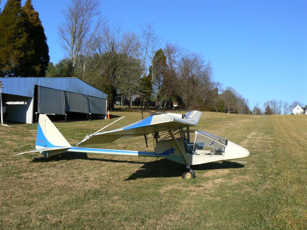

Besides all that Rev., it looks funky...
On a different note, my original Firestar has a canopy like the FS II in the
picture and the top of the fuselage sides (under the wing) are open as
well... Thinking I might cut a little wind and noise, I covered the
openings with Lexan and went out flying... The coverings cut my airspeed
considerably, I removed them and things went back to normal... A buddy
flying beside me, said he could see the difference in AOA with and without
the coverings... My theory is that the coverings robbed air from the
prop...

> Since the FSII flew hands off so well with a bunch of dihedral, decided to
> try it on the MKIII and see if it could also be made to fly hands off. You
> can see from the pictures how much dihedral is in the FSII, and how much is
> in the MKIII, but the results were not at all alike. Could not come up with
> a combination of trim or throttle settings that would enable hands off
> flight. It was better than before, but just barely, it was still impossible
> to pick up a low wing with rudder. There was a small amount of turbulence,
> but very small. Perhaps if I had a passenger so that it was balanced on each
> side, and the air was glass smooth, or maybe if I had a full fuselage that
> ran up to the base of the wing - who knows?
> Anyway, my initial tests show that dihedral is of no apparent value on
> this MKIII, your results may vary. None of the other flight characteristics
> seemed any different. Will probably put it back like it was. The gap seal
> fits better that way...

This one has a tapered Lexan fairing that goes behind the factory
cockpit enclosure, and we have flown it with and with out the rear
Lexan. Without the rear lexan fairing, the speed goes down, and it loses
some rudder authority. Since we have the Lexan tapered, hopefully it
enable wind to the prop.
