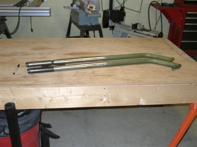

I think Kolb supplied two designs for the steel legs. A very flexible version
(I think Steve Green has these); and a very stiff, heat treated version which
I think is now the standard. I traded my old aluminum legs to Travis & bought
the new, stiff legs. I installed extensions so they go up to the top of the
"V" in the cage. I had to use carbide bits to drill these. They were very tough.
The deflection is minimal.
See attached pictures for the extensions and the legs.
Rex Rodebush

I think you may be a bit confused on the steel gear legs.
Normalized 4130 is stiff. When bent, it will remain bent.
Heat treated 4130 is flexible. When bent, it will return to its
original shape. It is now a spring.

The heat treated legs will seem very stiff until there is some weight
on them. Once you get the engine, wings, fuel, and your body in the
airplane, the legs will get quite flexible. Without the weight, they
will seem like they will not bend.

Hi John,
My understanding is that if you take a piece of 4140 normalized and bend it it
will deflect to the yield point and then deform. If you take the same piece and
heat treat it (heat, quench and draw) to a higher yield it will then bend and
deflect but will require a much higher force to bend the same amount and will
therefore be stiffer (and also harder with the higher yield).
If I'm wrong on this let me know.
Rex Rodebush

Rex:
"Forgot to mention in previous post.
airplane, the legs will get quite flexible. Without the weight, they..."
John,
I agree, I think we are saying the same thing.
Also, I did not change the wing incendence. These legs plus the fat tires will
set me up higher so I'm closer to a 3 point stall landing, which I want.
Rex

Rick:
No, I didn't do that. First I heard of it.
My legs and main gear mounts were designed and fabricated by Brother
Jim. I left the incidence per what was called for in the plans.
Would be nice to have less incidence, probably pick up a few mph by
having the tail boom fly straight through the air, rather than at an
angle which increases drag. A little late for that at this time.
Don't want to change windshield, quarter windows, and lift struts.
I am pretty happy with 88 mph at 5,000 rpm empty with 10 gal fuel. Of
course this slows down to around 80 to 85 when I am seriously loaded
to go traveling. Still a decent cruise speed that has proven, if I am
patient, I can get there and get home.

John / Rick,
kolb is suppling a new rear wing attach fitting that is slightly wider than the
old one. This allows you to add washers on either side to raise or lower the
trailing edge. I wanted these just in case I needed them for fine tuning. I
think they were made so you could compensate for the new gear. Travis could
give you the details.
Rex
