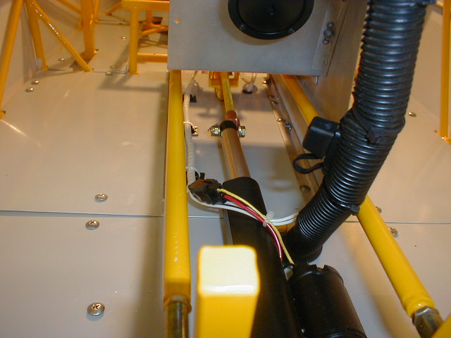

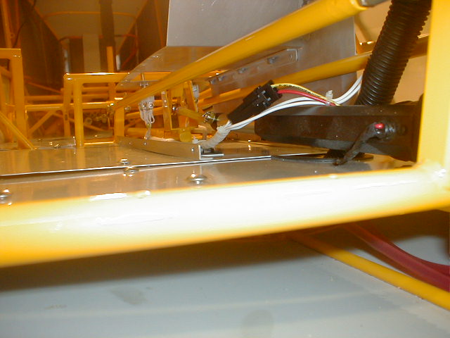

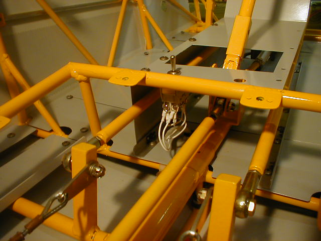

| Subject: | Trim system/Kolbra/Ms Dixie |
Hi gang,
Finished up the eletric flap and elevator trim system last night. Thought I might
share some photos. Headed to sun-n-fun tomorrow for the day then back to work
thursday. With some good luck and few interuptions we may move her to LUL this
weekend!
Paul Petty
Kolbra #12
Ms Dixie
Final assembly!
http://forums.matronics.com/viewtopic.php?p=107590#107590
