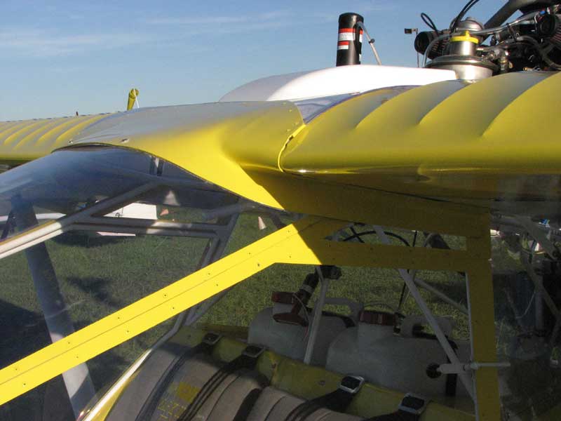

Here's few pics of the M3X at the Kolb display.
