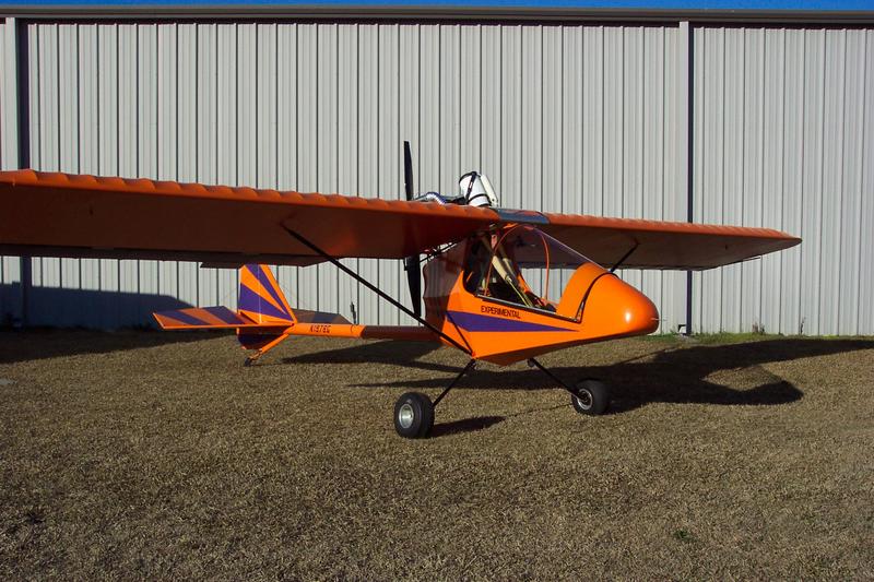

| Subject: | Re: FireFly Landing Gear Leg Strength Improvement |
Jack,
I very much enjoyed your detailed description of calculations and intended remedy
for gear leg bending. Please keep us posted on how that works out.
For what its worth, on my recent stall from a few feet into a pothole at Bob Bean's
field which broke the left wheel axle fitting and resulted in me ending the
landing upside down, the longer than standard 4130 tubing gear legs were not
bent in the process. This, even when the leg without the axle fitting dug into
the ground as I was still moving forward at about 30 mph.
I've become a believer in heat treated 4130 tubing gear legs. I have no idea if
they are heavier or lighter than the stock gear legs, which I know is always
important to you for staying under 254#.
[/i]
Thom in Buffalo
N221FA Allegro 2000 912UL
N197BG FS1/447
"Setting an example is not the main means of influencing another, it is the
only means."
Albert Einstein
http://forums.matronics.com/viewtopic.php?p=138809#138809

Message 5
the longer than standard 4130 tubing gear legs were not bent in the
process.
> Thom in Buffalo
Hi Thom:
To what RC rating were your gear legs heat treated?
I have been using 48 RC since we started experimenting with and using 4130
gear legs in 1988, on my FS and mkIII.
IIRC the weight of the mkIII aluminum legs were about the same or a tad more
than the 4130 legs.
I use 1 1/8" .120" wall 4130 legs on the mkIII and also on my FS.
In addition, my tailwheel strut is .120" wall 3/4" RC 48. I think the OD is
3/4.

Message 10
Thom, Of course, the other side of this coin, as Travis reminded me, is that
aluminum gear legs save cages.
No use speculating on how your arrival would have gone if you'd have had
aluminum legs, but I've done some real whack's, straightened the legs that
night, and flown the next day.
Rick
Thom,
I really don't want to get away from the aluminum legs. They are a great safety
feature in that they do bend so easily. It saves the cage and the pilot. I
want the cable to act as a fuse that breaks when the load becomes too great.
This will absorb a lot of the impact energy from a plop, and then, if necessary,
the leg can bend to absorb even more.
The cable will have little to no effect for dropping a wheel into a hole. I see
this as desirable. I would want the leg to bend to the rear to save me and
the cage. If, I can remember to use five degrees of flaperon, I should be going
about 26 mph under no wind conditions.
The good thing about bending gear legs is that it makes you re-evaluate your landing
technique. Lately, I have been making very, very good landings.
Jack B. Hart FF004
John,
I have no idea to what RC the legs were heat treated to because it was done by
someone else before I bought it. I only know that it was done or the tubes would
have buckled in a heartbeat without the heat treating. They look sort of funny
because even with the FS empty, they are slightly bowed and have visually
obvious negative camber but no toe-in/out that I can tell. When loaded with me
and fuel I'm sure it looks even stranger but they track straight and true and
don't bounce much at all with imperfect touchdown. I expect that with much use
on paved runways, where I'm located, the inside sides of the tires will wear
first, then I'll turn them around and wear out the other side.
Great gear legs is all I can say. If my pothole landing did not result in damaged
sockets it is unlikely I'll ever have that problem, without breaking a lot
more too.
Almost done with the wingtip structural repair. Boom tube is next.
Thom in Buffalo
N197BG FS1/447
only means."
Albert Einstein
http://forums.matronics.com/viewtopic.php?p=138889#138889
They look sort of funny because even with the FS empty, they are slightly
bowed and have visually obvious negative camber
> Thom in Buffalo
Thom:
The 4130 legs can be pressed straight or a little past straight to give you
some positive camber. Not only does it look much better, but when loaded up
from landing forces, the positive camber will get pulled toward neutral
camber and load everthing more evenly.
Negative camber makes the airplane look like it just finished making a hard
landing.
One can also persuade the axles to bend the wheels back to positive camber
by blocking up the gear leg/axle socket, pulling off the wheel, slipping a
piece of water pipe over the axle snugly, and stepping on the pipe. That is
how I kept my FS axles happy.
Message 18
you
Gang:
Forgot to add something to the last.
Not a good idea to try flying with 4130 gear legs that have not been heat
treated. Prior to heat treating they will be extremely stiff, and bend
permanently if stressed to much.
After heat treating the legs become very springy, because they are springs.
At 48 RC they make a good spring, but when pushed over the limit, they will
bend before they break. I do not know where that RC number is that will
make them brittle. I have had great luck with 48 RC.
