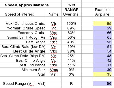

    On April 5, 2007 I posted a spreadsheet showing the approximate relationship among the V-speeds on light aircraft. If you have spreadsheet software you can view it and use it. If you don't you can get a good estimate of the Vx speed for your airplane if you know the clean stall speed (Vs1) and max continuous cruise speed (Vh). Subtract the stall speed from the max. continuous stall speed and multiply that number by 14% and add it back to the stall speed. Example: Vh = 85 mph Vs1 = 35 mph Vh - Vs1 = 85 - 35 = 50 50 x 14% = 7 7 + 35 = 42 42 mph would be a good estimate for Vx for this airplane. -------- Thom in Buffalo N221FA Allegro 2000 912UL N197BG FS1/447 -------------------- &quot;Setting an example is not the main means of influencing another, it is the only means.&quot; Albert Einstein Read this topic online here: http://forums.matronics.com/viewtopic.php?p=140602#140602

    While I'm at it I figure it wouldn't hurt to attach a jpg image of the approximate v-speed relationships to Vh and Vs1. See attached image and use following formula for approximate V-speed of interest. R = Vh - Vs1 where R = speed range Vh = max. continuous airspeed Vs1 = stall speed without flaps General formula or approximate V-speeds: R x %(V speed of interest) + Vs1 = approximate V speed of interest -------- Thom in Buffalo N221FA Allegro 2000 912UL N197BG FS1/447 -------------------- &quot;Setting an example is not the main means of influencing another, it is the only means.&quot; Albert Einstein Read this topic online here: http://forums.matronics.com/viewtopic.php?p=140609#140609 Attachments: http://forums.matronics.com//files/v_speed_relationships_167.jpg

    Hi Bob, Isn't it all in the book 90-89A.... Seems to me that it's figured from the stall speed.... To get you in the "ballpark"..... Like you said....you write what you want... Gotta Fly... Mike & "Jaz" in MN - Vx 40 , Vy 50 (FSII) slyck(at)frontiernet.net wrote: > For EAB a logbook entry is all that is required. Nothing to send in. > You can write anything you please for those V speeds. > > BB do not archive -------- . . . . . Do Not Archive Read this topic online here: http://forums.matronics.com/viewtopic.php?p=140703#140703
