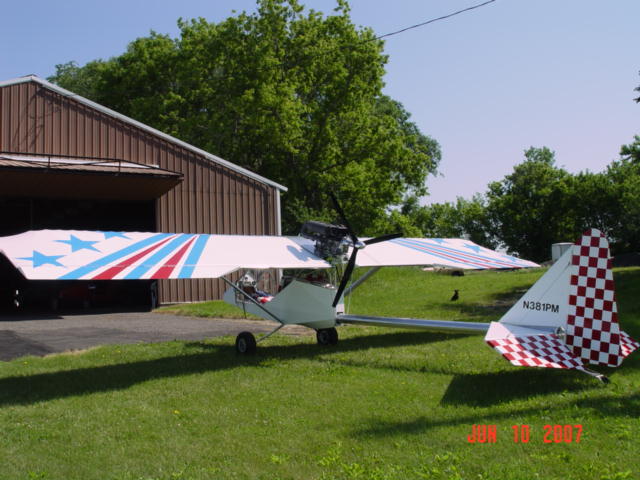

Hey Guys,
In the picture of Crystal's Plane....
Look at the "trim tab"....is that "size" really needed ?
Seems too big , almost like it could cause "Flutter"
it's almost touching the ground , I'll bet it has.
Gotta Fly...
Mike & "Jaz" in MN FSII/ No trim tabs

My trim tab does drag ground if I don't keep my stick pulled back. I keep a bungee
cord on it when I'm not in it.
I don't know if it's my trim tab that is too big. When I look at the picture of
ropermike's Mark II, his trim tab looks to be about the same size.
However it looks like his tailwheel keeps the back of the plane up higher than
mine. Kmet suggested (thanks Jim) I turn the tailwheel landing gear rod around
back there to make it higher, but I'm not sure exactly what part he's talking
about (the whole rod or just the attachment at the end). Let me get a close
up picture of my tailwheel assembly and post it here. I'll try to get it this
afternoon. I'm having to replace the nut back there with a castellated nut
(per the DAR) so I have it apart right now anyways.

Hi Crystal,
I'm sure he's talking about turning the rod over...
it might be a little "sprung" , you can use that to your advantage by
giving it a 180....
You can't always Taxi with the stick "back" ( some do )
Sometimes it's confusing , which way to hold the stick ( Not anymore )
One of the best "sayings" that I heard when I was getting my Tailwheel
endorsement was this....
"Wind Behind" - Blows the stick
"Headwind" - Pull Back , stick into the wind
That "saying" helps me "Just do it" , instead of thinking about it...
