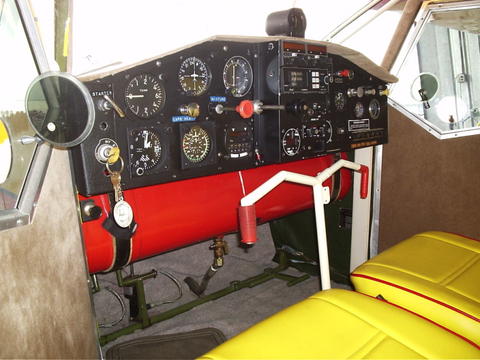

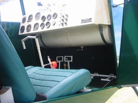

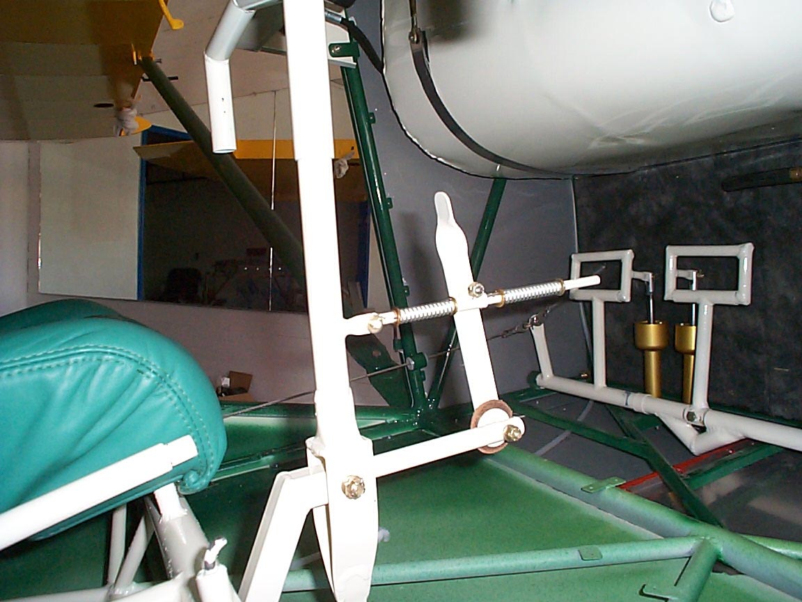

The Buttercup & Tailwind also use this stick in the middle...
The left side control is permanent and the right side will come off
with one bolt....They also do this from below , so the stick comes up
between yer legs... That style was in the Tailwind I got to fly.... But
I don't have pictures ( Right side came off with one bolt too )
Gotta Fly...
Mike & "Jaz" in MN
PS I threw in a picture of the SIMPLE trim system...
