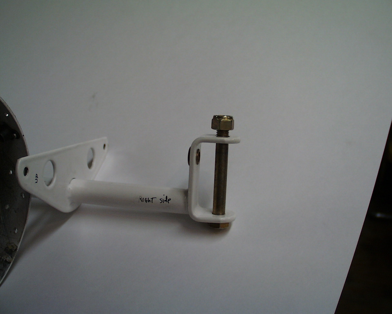

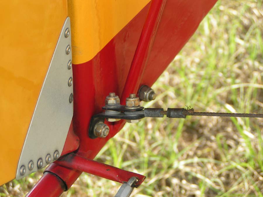

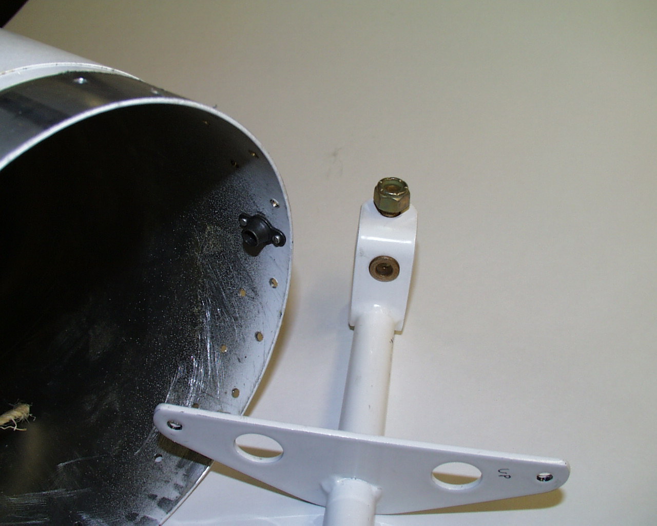

John,
Saved ya the trouble of taking pics.
Scott

Morning Scott:
Great!!! Thanks, buddy.

John , I don`t mean to nit pick. However, I was always taught to insert
bolts from top to bottom, not bottom to top. Is there a reason you
installed the bolts the way you did? Perhaps it is just easier to check
them when preflighting. Lanny FSII
Lanny:
Looked better/more normal that way. Heads on the outside, tails on the
inside.
You don't think they will fall out do you??? :-)
If you look my plane over you will find other places where bolt are inserted
from bottom to top, like at the upper end of the lift strut.
Remember, when I am flying upside down, there are more bolts inserted from
bottom to top than there are from top to bottom.
Seriously, I try to keep thing uniform. Looks better and is a lot easier to
check.

Message 13
| Subject: | Re: Check your Horiz. Stblzr bolts |
Jimmy
I think I know the area your talking about. I saw this could be a problem
down the road with wear on the two attach bolts at the boom tube. I have attached
pictures showing how I'm avoiding this problem. Your really lucky you caught
this before things turned loose in flight. The bushings you see in the pictures
came from Wicks, part# SF812-4 and cost less than a dollar each. Two
nut plates, four rivets, two bushing and a little work is all it takes to fix
it right.
Rick Lewis
http://forums.matronics.com/viewtopic.php?p=227431#227431
http://forums.matronics.com//files/pic00010_942.jpg
http://forums.matronics.com//files/pic00009_168.jpg
Message 14
> Rick Lewis
Rick L:
I haven't experienced a problem with the elevator control mechanism.
I think the problem was up at the forward attach points.
I fixed mine with a 4130 bushing I made from a piece of 1/4" tubing with a
3/16" ID. Works good.
Again, I don't think I have photos of the installation.
Let us know how your modification works out after you get some time on them.
