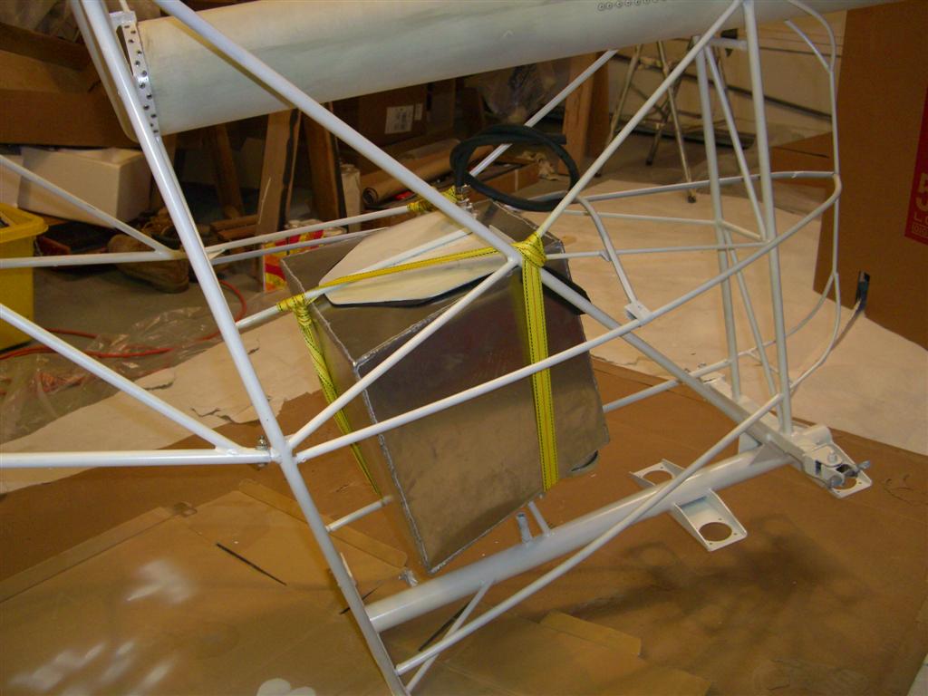

Here is the company that made my 8 gal tank. The tank is working great. No leaks. http://www.alumiworx.com/cart/index.php?act=viewProd&productId

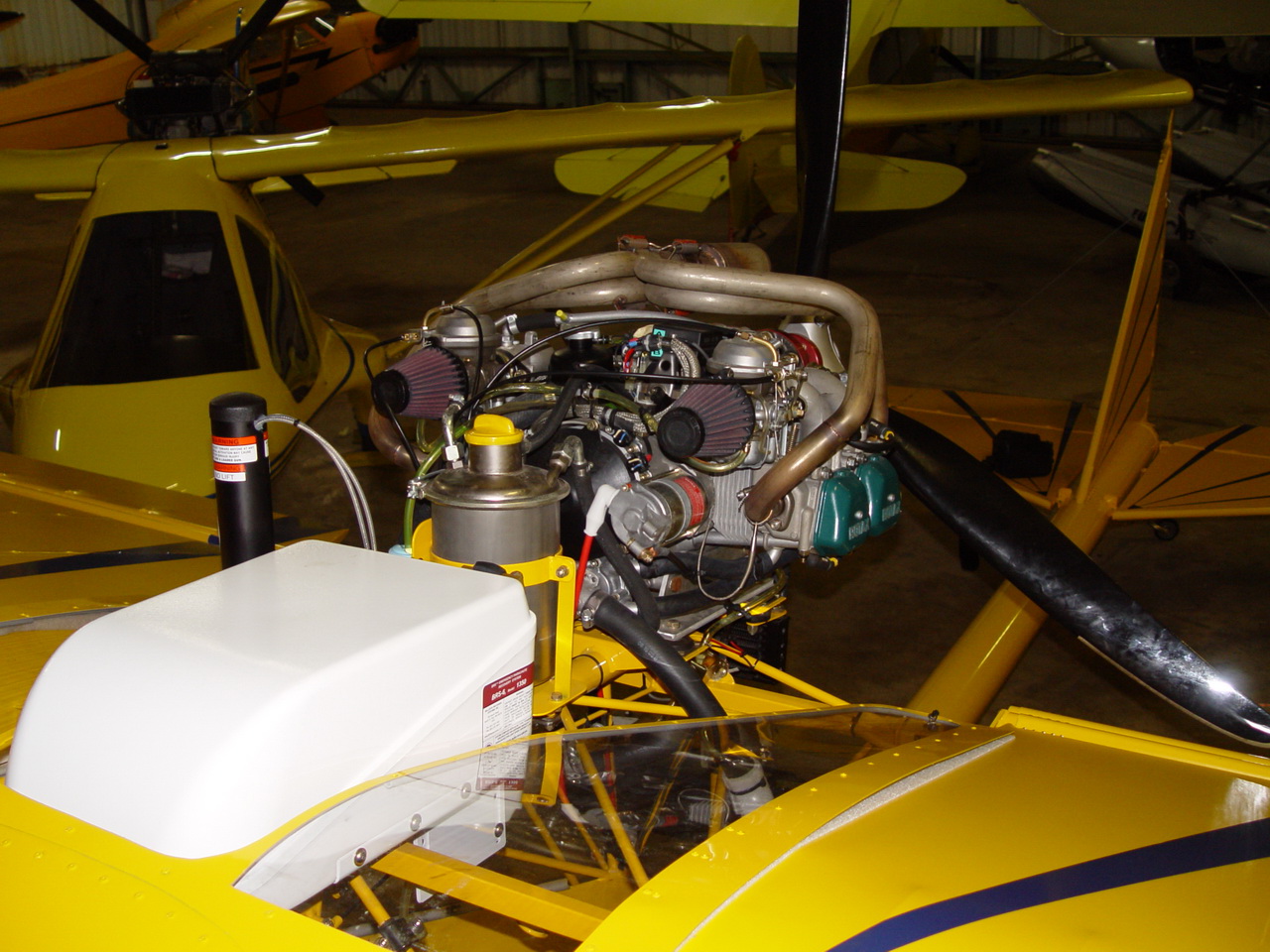

I have the VLS on my Kolb MK III Xtra, and although I have not tried it yet, it
seems very good good for the airplane [Wink] The fit of the VLS pack is
PERFECT for the top of the MK III Xtra, I like it much better than the canister
! I will post some pictures of it in a little while so that you can see for
yourself.

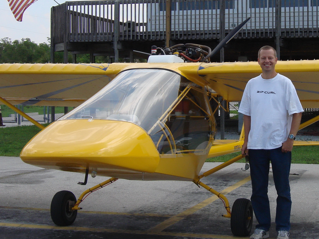

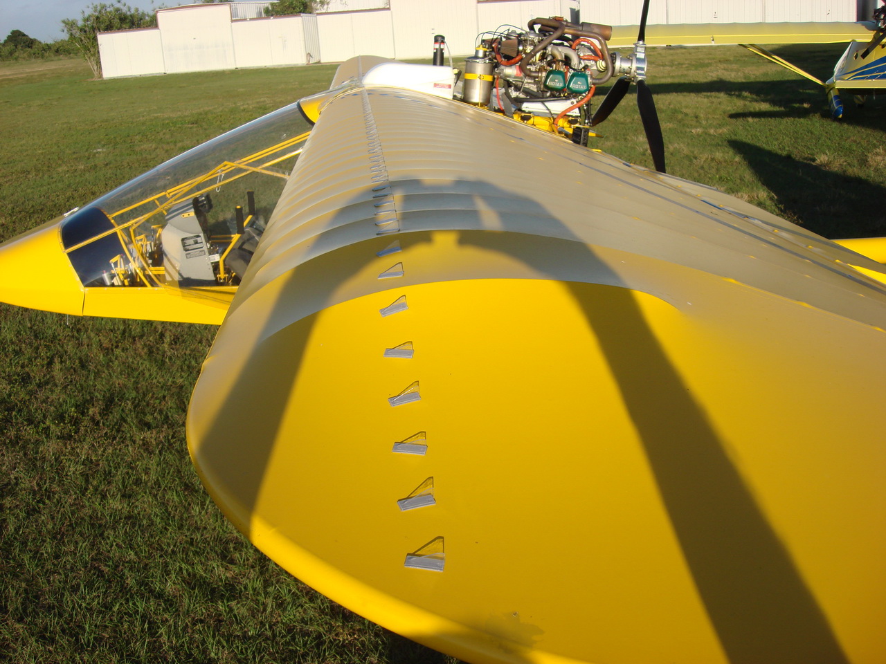

Here are three pictures showing the BRS, the VLS pack just sits in the top of the
MK III like it was built for it !
