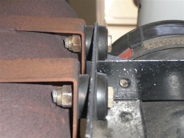

Good morning Cristal;
Yes, the rubber bushings should be on the muffler bracket and not on one
side of the muffler bracket and on half on the back side of the support
angle.
The cracked bracket could be contributed to the set up and also could just
be fair wear and tear from vibration.
I would suggest grinding the washer off the muffler bracket and welding an
1/8" thick plate the full length of the bracket where the washer is located
now. Just weld the sides of the muffler bracket, not across the top or
bottom as that will cause a stress point where the bracket bends.
Ha, you live to far away or I would weld it up for you.:)

Ralph B wrote:
> 1) the reason it cracked is that you have the old style single-jointed muffler
with one set of 3 springs. These older mufflers are prone to cracking.
> Ralph B
This is a good point. These older style mufflers had only one point in the tubing
where they could flex. A common area of cracking on these is in an almost perfect
circle right at the seam where the main expansion tube goes into the can.
I had an eipper style one of these older mufflers on my quicksilver that gave this
exact circle-wise cracking in that area. Got a friend to TIG weld a new bead
around there which fixed it.
But you have to pay very close attention to the tension of the springs and the
muffler mounting with the old style. They can't be too tight to where they prevent
movement of the joint, a common installation problem. Anti-sieze on the parts
during assembly helps a bit as well.
But the new style with the seperate elbow is a lot better as it has 2 joints where
the whole works can move and better isolates the vibration of the motor from
the muffler.
The Kolb mounting design with the bracket bolted to the heads is actually very
secure and gives good support for the can (mine would hold the muffler can perfectly
in place even with no elbow installed yet) so repairing the bracket may
be all you need to do.
But if it keeps cracking, you might want to replace the muffler with the new style......
LS

| Subject: | Re: Broken exhaust bracket |
> angle.
> Jim
I found what I think is the rubber bushings that was used originally. In the CPS
catalogue I found part numbers 9406 (male bushing) and 9408 (female bushing):
http://www.rotaxparts.net/scripts/prodView.asp?idproduct=838
However a friend mentioned that I should probably use barry mount isolators:
http://www.greenskyadventures.com/Installation_items/vibmntimages.htm
However it looks like there are various ones to choose from (according to the chart
at the bottom of that webpage). Has anyone used these and if so, which ones
(what series and color)?
Cristal Waters
Kolb Mark II Twinstar
Rotax 503 DCSI
http://forums.matronics.com/viewtopic.php?p=235691#235691
cristalclear13 wrote:
> - - - snip- - -
> I know there aren't many of you out there that have a 503 anymore and probably
don't even have the same set up for the exhaust if you do have a 503, but if
you have something similar could you please post a picture and/or diagram?
> - - - snip- - -
Cristal:
Know you've gotten lots of input since the posting..... but here's a picture of
my set up on my FSII. (R503).
If you go with the recommended bushings from CPS, don't forget the backing washers.
George Alexander
FS II R503 N709FS
http://gtalexander.home.att.net
http://forums.matronics.com/viewtopic.php?p=235696#235696
http://forums.matronics.com//files/503_muffler_mount_003_small_423.jpg
