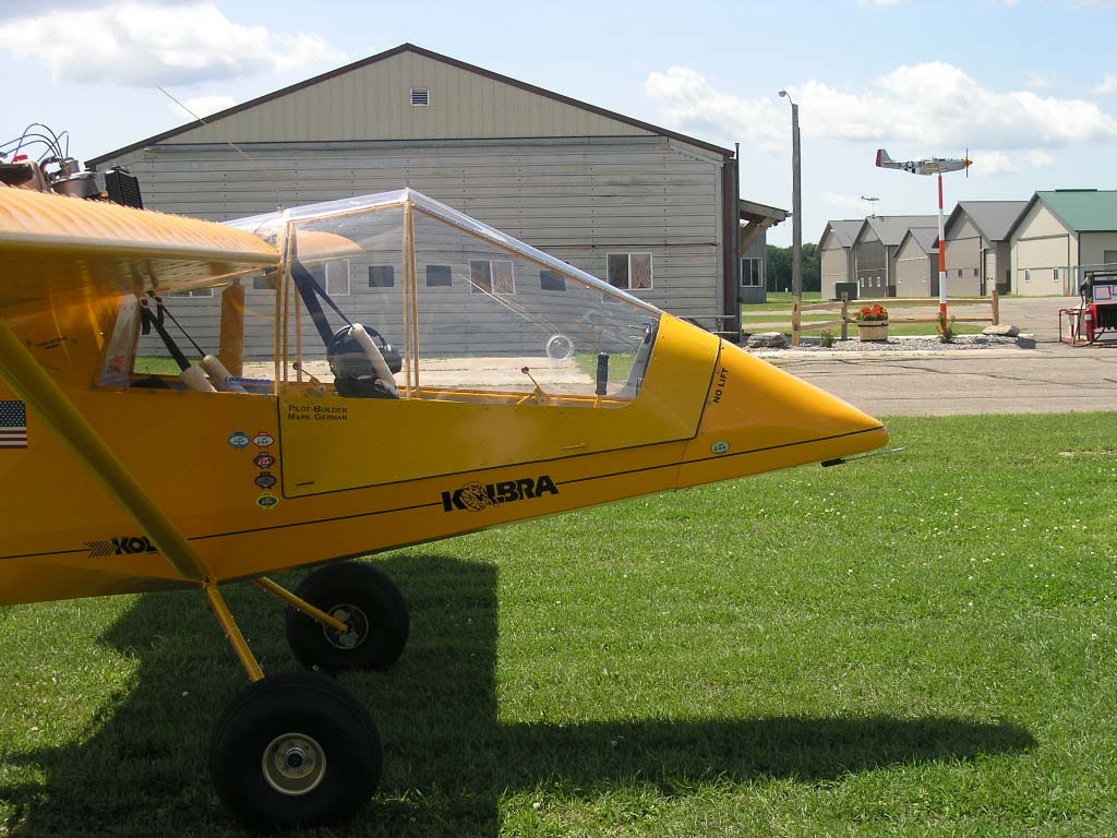

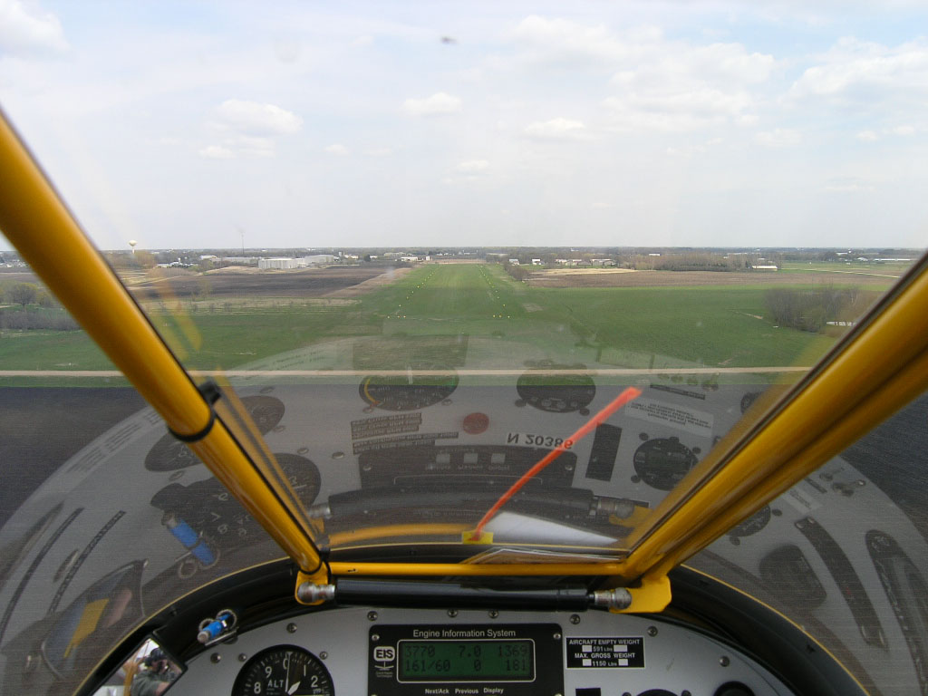

> Winsted in what state? I lived in Winsted, Ct. for a year, and that photo doesn't
look like it.
> do not archive
> Bill Sullivan
> Windsor Locks, Ct.
> FS 447
Bill, this is Winsted Minnesota. It's about 40 miles west of Minneapolis. Here
are a couple more pictures of that airport.
