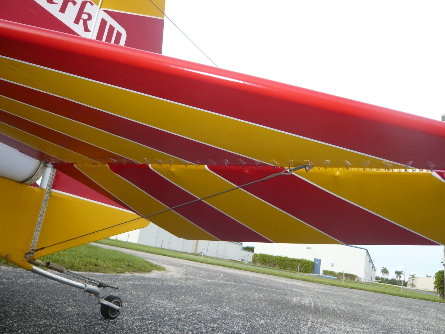

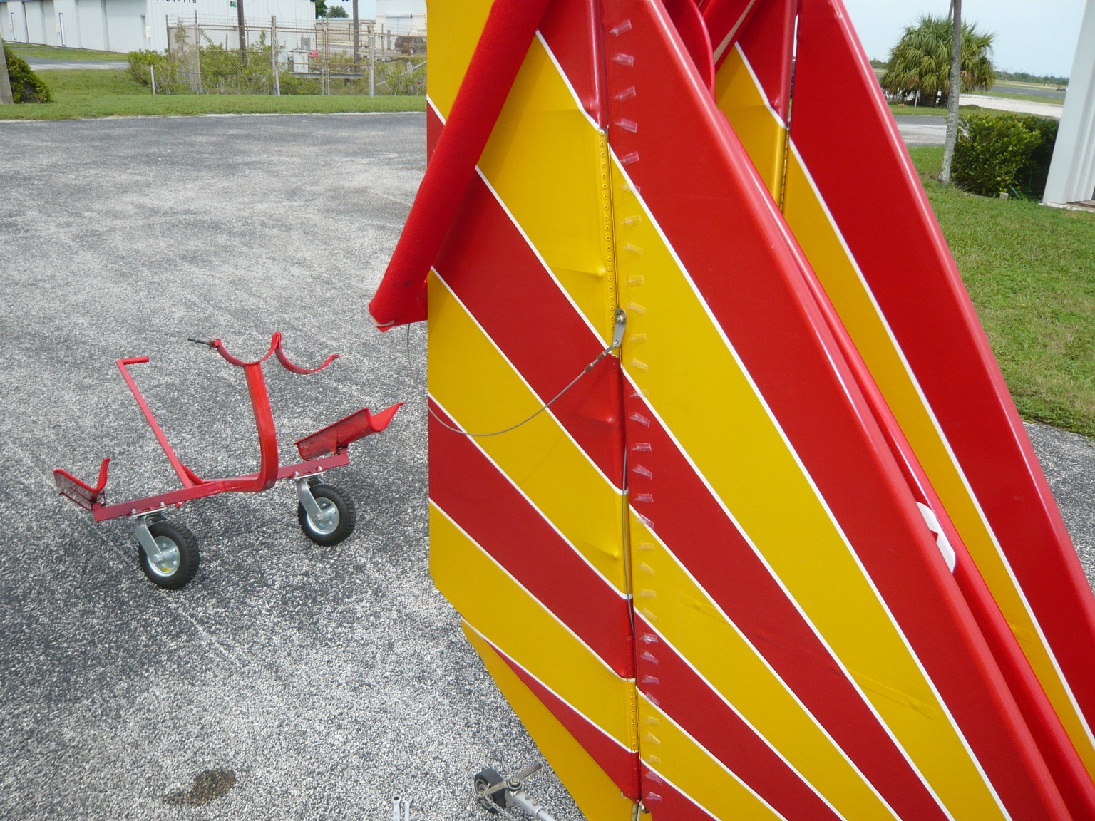

Jimmy, I thought long and hard about whether to post this to the forum or to
contact you directly. I decided to go to the forum because I believe this is
a safety related issue.I believe you need to redo your cables.
Here's why: This is from FAA publication 43.13 1B "Acceptable Methods,
Techniques, and Practices - Aircraft Inspection and Repair", Chapter 7.
Aircraft hardware, control cables, and turnbuckles, Page 33:
c. Thimble-Eye Splice. Before undertaking a thimble-eye splice, initially
position the cable so the end will extend slightly beyond the sleeve, as the
sleeve will elongate somewhat when it is compressed. If the cable end is
inside the sleeve, the splice may not hold the full strength of the cable. *It
is desirable that the oval sleeve be placed in close proximity to the
thimble points, so that when compressed, the sleeve will contact the
thimble as shown in figure 7-14. The sharp ends of the thimble may be cut
off before being used; however, make certain the thimble is firmly secured
in the cable loop after the splice has been completed. When using a sleeve
requiring three compressions, make the center compression first, the
compression next to the thimble second, and the one farthest from
the thimble last.*
(Note: Bolding and italicizing done by me for emphasis)
Compare figure 7-14 with the second photo from your post. When you installed
the Never Kinks you failed to reclose the end of the thimbles. This has
provided a place for the end of the thimble to wear the cable strands and it
is almost completely uninspectable. There is also a danger that the cable
can flex and come off the thimble entirely so that the cable will ride
directly on the hole in the tang.
Never Kinks: I would not use them. They were created originally for the
generation of hang gliders (circa 1976 / 77) with pop open setup that pulled
all the cables taught when the frame was fully extended. If the cable was
twisted on the tang the thimble would get kinked, hence the name. This is
not a concern on the tail of the Kolb because you must connect the lower
wires at the base of the vertical stabilizer. If a thimble is twisted it
becomes immediately obvious as it is impossible to assemble the tail until
the twist is removed. The problem is, like the open thimble they create an
uninspectable area in the cable assembly in the area John H. warns about,
the contact area of the thimble and the tang.

Rick, quite right. As an A&P I should have caught that too. _I
didn't look close at the second pic.
It won't fail today or tomorrow but it will wear faster with the nico
not snug to the thimble.

> Kolbers,
> I installed all new tailwires after I found my cracked tang
> recently. The tangs are 12 GA single-hole stainless with a "never-
> kink" bushing and the cable is 3/32 stainless. I got the supplies
> from Air-Tech in New Orleans.
> The thicker tangs should hopefully never be a problem. I'm not sure
> what the thickness is on the 4 hole tangs, but these are about 50%
> thicker. I have never done any cable rigging before, and used a
> "split-bolt" to hold the cables after I tightened them up prior to
> swedging the nico-press connectors. I did have the turnbuckles on
> before, but now I don't. I'll have to keep an eye on them to watch
> for any stretching or loosening of the cables, as I'm not sure if
> they tend to stretch over time.
> We had a much needed rain out today here in the Houston area, so it
> was a good day to do maintenance. Also changed my break-in oil on
> the HKS, and may get to fly some tomorrow weather permitting.
> Jimmy Young
> FS II, HKS 700
> N7043P

Compare figure 7-14 with the second photo from your post. When you installed the
Never Kinks you failed to reclose the end of the thimbles. This has provided
a place for the end of the thimble to wear the cable strands and it is almost
completely uninspectable. There is also a danger that the cable can flex and
come off the thimble entirely so that the cable will ride directly on the hole
in the tang.

On Sat, Sep 12, 2009 at 8:08 PM, Jimmy Young <jdy100@comcast.net> wrote:
Kolbers,
I installed all new tailwires after I found my cracked tang recently. The tangs
are 12 GA single-hole stainless with a "never-kink" bushing and the cable is
3/32 stainless. I got the supplies from Air-Tech in New Orleans.
The thicker tangs should hopefully never be a problem. I'm not sure what the thickness
is on the 4 hole tangs, but these are about 50% thicker. I have never
done any cable rigging before, and used a "split-bolt" to hold the cables after
I tightened them up prior to swedging the nico-press connectors. I did have
the turnbuckles on before, but now I don't. I'll have to keep an eye on them to
watch for any stretching or loosening of the cables, as I'm not sure if they
We had a much needed rain out today here in the Houston area, so it was a good
day to do maintenance. Also changed my break-in oil on the HKS, and may get to
Jimmy Young
FS II, HKS 700
N7043P
>> Kolbers,
>> tangs are 12 GA single-hole stainless with a "never-kink" bushing and the
>> cable is 3/32 stainless. I got the supplies from Air-Tech in New Orleans.
>> the thickness is on the 4 hole tangs, but these are about 50% thicker. I
>> have never done any cable rigging before, and used a "split-bolt" to hold
>> the cables after I tightened them up prior to swedging the nico-press
>> connectors. I did have the turnbuckles on before, but now I don't. I'll have
>> to keep an eye on them to watch for any stretching or loosening of the
>> cables, as I'm not sure if they tend to stretch over time.
>> good day to do maintenance. Also changed my break-in oil on the HKS, and may
>> Jimmy Young
>> FS II, HKS 700
>> N7043P

Message 8
| Subject: | Re: New tailwires installed |
Two, two edges. I really need to get a better proof reader.
Rick
On Sun, Sep 13, 2009 at 8:03 AM, Richard Girard <aslsa.rng@gmail.com> wrote:
> Bob, Years ago I used a sailboat tang on a glider I rewired. The tang had a
> piece of tube swaged into one hole like a grommet so the contact surface
> between tang and thimble was a broader area than just to edges of a hole.
> Rick Girard
> On Sun, Sep 13, 2009 at 7:48 AM, robert bean <slyck@frontiernet.net>wrote:
>> Rick, quite right. As an A&P I should have caught that too. _I didn't
>> look close at the second pic.It won't fail today or tomorrow but it will
>> wear faster with the nico not snug to the thimble.
>> If and when I redo my tail cables I want to create tangs that don't have a
>> sharp wear edge on them.
>> BB
>> to contact you directly. I decided to go to the forum because I believe this
>> is a safety related issue. I believe you need to redo your cables.
>> *It is desirable that the oval sleeve be placed in close proximity to the
>> the thimble last.*
>> installed the Never Kinks you failed to reclose the end of the thimbles.
>> This has provided a place for the end of the thimble to wear the cable
>> strands and it is almost completely uninspectable. There is also a danger
>> that the cable can flex and come off the thimble entirely so that the cable
>> will ride directly on the hole in the tang.
>> Rick Girard
>>> Kolbers,
>>> Jimmy Young
>>> FS II, HKS 700
>>> N7043P
>>> Read this topic online here:
>>> http://forums.matronics.com/viewtopic.php?p=262735#262735
>>> http://forums.matronics.com//files/dscn0501_391.jpg
>>> http://forums.matronics.com//files/dscn0505_107.jpg
>>> arget="_blank">http://www.matronics.com/Navigator?Kolb-List
>>> le, List Admin.
>>> ="_blank">http://www.matronics.com/contribution
>> <AC 43.13 1b figure 7-14.jpg>
Message 9
Good Morning Gang:
It is the concensus of the Rock House Flying Club, me and Larry C, that
we would fly with Jimmy Y's tail wires.
Not to be contrary, I agree his terminals don't agree entirely with the
AC. However, I don't think they are going anywhere any time soon. In
fact, I think where will be reduced if the Never Kink reduces vibration
on the thimble and tang.
I missed Jimmy's photos initially. The main thing I would have done
differently would be to make the bends as close to the bolt and washer
as possible to reduce side bending forces. I like the cable to pull as
straight from the point of attachment as possible.
Again, my own personal opinion and worth what you all paid for it.
Rock House, Oregon, Flying Club (among other things) ;-)
or to contact you directly. I decided to go to the forum because I
believe this is a safety related issue.
Rick Girard
Message 10
Hey Gang:
Shoulda proofed my previous. "where" should have been "wear".
any time soon. In fact, I think where will be reduced if the
Message 11
| Subject: | New tailwires installed |
No problem=2C John. We'll let this one slide=2C but watch it! (just kiddi
ng....weekend humor)
BTW=2C I concur that although the cable end isn't constructed exactly as it
should have been=2C in my opinion I wouldn't go to the trouble of chucking
them out and starting over just yet.
Rick is right=2C they weren't built like they should have been=2C but I thi
nk I'd just keep a close eye on them=2C and leave them alone.
Just my opinon=2C too.
Mike Welch
From: jhauck@elmore.rr.com
Subject: Re: Kolb-List: New tailwires installed
Hey Gang:
any time soon. In fact=2C I think where will be reduced if the
Ready for Fall shows? Use Bing to find helpful ratings and reviews on digit
al tv's.
http://www.bing.com/shopping/search?q=digital+tv's&form=MSHNCB&publ=W
LHMTAG&crea=TEXT_MSHNCB_Vertical_Shopping_DigitalTVs_1x1
