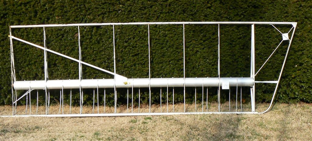

Hey Jack B. Hart, last year on Aug 26, you posted a link to an interesting study
on wing tip shapes.
http://naca.central.cranfield.ac.uk/reports/1923/naca-report-140.pdf
It made sense, would be as easy to make as the regular tip, and if it didn't work,
probably would'nt hurt. The other link you posted was along the same line,
even more interesting, but has since been taken down.
Ed liked the idea, the rebuild process is still coming along, and here is the first
tip. Not as radical as what the link said was ideal, but didn't require any
major mods either.
Just so you'll know somebody out here is paying attention...
Richard Pike
MKIII N420P (420ldPoops)
PS: No, the trailing edge is not curved, that is the wide angle lens effect.
