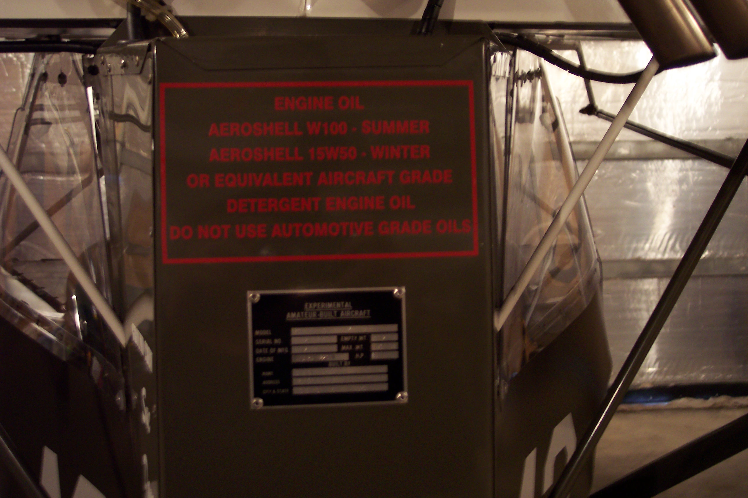

My inspector didn't care as long as it was on the out side of the aircraft...mine
is at the tail of the fuselage..

In my case the inspector said the reason the manual calls for it to be
somewhere in the tail section is because in a lot of crashes that is the
only thing left in case of fire or something like that. Bill
