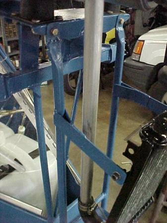

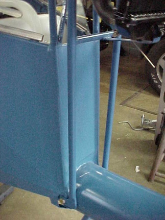

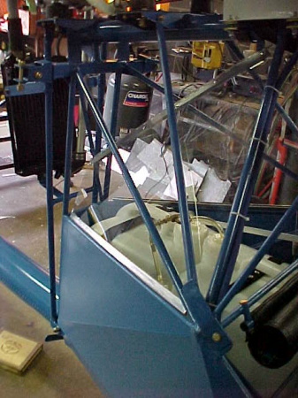

http://forums.matronics.com//files/fsiimmbrace1_656.jpg
http://forums.matronics.com//files/fsiimmbrace2_509.jpg

t: RE: Kolb-List: Fw: Cracked spar on fire star.=0A=0A=0AFrank,=0A=C2-=0A
There are 2 issues:=0A=C2-=0ARoughly speaking, an HKS has approximately t
wice the power impulse than a =0Atwo-stoke because it has only half of the
power pulses.=0A(A 2-stroke piston fires every time in goes down, but only
every other time on a =0A4-stroke.)=C2- So the HKS will place a higher st
ress on the structure than a =0A2-stroke of comparable power.=0A=C2-=0ASo
mewhere along the way, the brace gusset from the motor mount got moved to t
he =0Acenter of the square tube.=C2- Formerly it was welded to the leadin
g edge of the =0Asquare tube.=0AOn your frame the power pulses are transmit
ted to the center of the thin wall of =0Athe square tube =93 this wil
l result in a certain amount of flexing which could =0Apossible lead to the
cracking you have.=0A=C2-=0AA possible fix would be the addition of a gu
sset to get the forces directly to =0Athe corner of the square tube.=0A=C2
-=0AIf someone is going to sound an alarm about the cracking, I think a d
istinction =0Acould be made between the frames that have the center orienta
ted location vs the =0Aedge oriented location.=0A=C2-=0ADennis=0A=C2-
