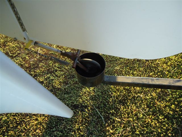

I'm looking into different ways of towing my Firestar a short distance to my local
airport, about 6 miles, for its first test flight. Does anyone here see a
downside to this technique ?

Dennis T/Folks:
I used similar method to haul my US and FS from home to my airstrip, 3
miles.
Major difference was a positive mechanical connection, rather than a
tailwheel sitting in a cup. At least that is how the photo looks to me.
I removed the tailwheel, used the tailwheel strut end fitting to attach to a
home made draw bar on my tractor. A 1/4 aircraft bolt and nut, used as a
pin, secured it to the draw bar.
Never had a problem.
I now have a 28' deckover goose neck I haul the mkIII with. Bought the
goose neck to haul antique tractors, but it does a good job hauling the
little mkIII.
Please note. I did not haul the US and FS with the wings attached, fuselage
only. I used a padded utility trailer to haul the wings, one at a time.

I use to haul my Firestar about 6 miles 45/50 MPH all the time behind my
pickup on its main gear I just secured the tail wheel so it couldnt get
out of the mount I fabricated

That should work provided the road is smooth. Remember humps will cause
bumps in those wing leading edges.
The firefly and firestar don't have too much weight to contend with.
For security I stuck a trailer hitch on a steel rod to tow my MkIII by
tractor. (wings off) That is a harbor freight tow dolly for pulling it
into the
basement.
Never try to tow a MkIII with the wings folded. Good for pushing into
and out of a hangar only.
For one you will be permanently crippled after you try to lift it.
Secondly, the weight will bend the stock aluminum
tail rod after some jouncing.
BB

Painting the tailwheel assembly wouldn't hurt any.
