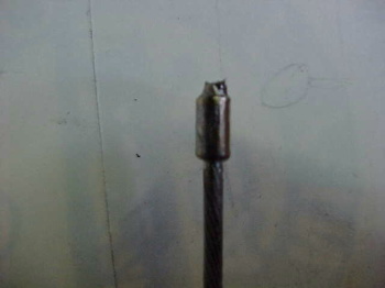

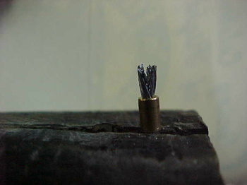

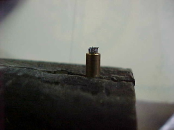

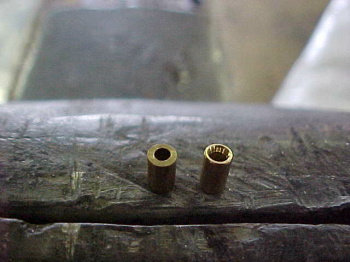

If you make up your own cables, you can easily guarantee that the cables will not
pull out of the swedge. There is a countersunk end on the swedge, push the
cable through so that the countersunk end is at the cable end. Push about 3/32"
of cable through and then rat tail it severely with a small tool, and then pull
it back in as far as it will go, it should be physically impossible to pull
it through. If that is the case, then solder it.
The attached pictures ought to give you the idea.

| Subject: | Re: throttle cable splitter failure |
List,
I think my problem was I did not have my throttle stop positioned properly. At
full throttle I still had about 3/8" to go to get to the throttle stop, so I've
probably been flying around for the past year & a half over-stressing the cable.
I'll take car of that.
Rick, The ferrule was soldered. The only kind of soldering I know of is hot, don't
know what cold soldered is. Guess I should learn though.
Rev. Pike, thanks for the photos and tip. I'll do that as well.
Frank Goodnight suggested I set the throttle cable at the carbs to go to full throttle
upon any cable failure and explained how to do it, probably will do that
too.
Thanks for the help-
Jimmy Young
Missouri City, TX
Kolb FS II/HKS 700

Message 10
Without trying to refute what some of our learned colleagues have said about soldering
cable ends.......
For another view, here is the contents of a post April 2006:
George Alexander wrote:
> MAY BE A DUPLICATE RESPONSE... but anyway
> Although nico sleeves weren't involved, from a personal experience, I would like
to support what Ted said about heating the cable.
> In my case, the throttle cable was heated and solder applied to keep it from
slipping through the connector to the throttle lever. The good news is that it
snapped, on the ground, as part of my regular preflight. (Open the throttle to
full and close it listening for the infamous "click" of the slides as they return
home. They certainly clicked this time when the cable let go and they went
home in a hurry!)
> On examination, there was noticeable discoloration from the point that was soldered,
back about 1". The general consensus, of those that examined it, was that
the break was caused by the effect on the cable of the heat application. (The
failure may have been accelerated by the humid conditions here in FL.) The
cable actually rusted through. Miffed that I didn't see the rust before it broke.
Some of the discoloration/rust protruded from the connector enough to be
seen. Conceptually a good idea, with not so good results.

Message 11
After seeing how the cable splitter works, (I had never opened one up
before this) I am interested if anyone else on the Kolb list has ever
had this happen? It's something you will not catch on a pre-flight.
the best prevention for this happening is to have a throtle quadrant
stop,, adjusted so the cable can't be over tight when pulled to idle for
the 912's or WOT on the 2 strokes.
boyd young
mkiii
Message 12
Hi George,=0AI believe- accepted procedure is to dip the cable in molten
solder rather than =0Aheating the cable.=0AThat way the cable never gets ov
er 300 degrees or whatever temp the solder is. I =0Adon't think the cable
=0A=0Ais affected when it's done this way.I have also had a cable corode un
till it =0Abroke ( I live near salt water & =0A=0Athe salty air got it) , n
ot visable on even a good preflight only wa-to check is =0Ato desolder th
e cable and remove=0Ait from the housing and resolder afterwards---I do it
-2 times a year, takes less =0Athan an hour, worth it to me.=0AFor-what
its worth.=0AFrank Goodnight-=0A=0A=0A=0A=0A____________________________
