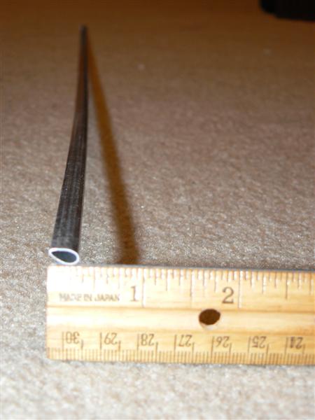

This is overexposed, but you get the idea: OD 5/16" X 5/32" X 35", ID 1/8" X 1/4".
Got it at the local RC hobby shop, thinwall aluminum, weight 1/2 oz. Ought
to be able to slip a tail brace wire through it during cable assembly, Goop it
to an end fitting to keep it from pivoting. Use 2 pieces, each one attached
at an end fitting, leave the middle of the wire uncovered so you could still fold
the tail? Maybe squeeze it thinner so that it has less cross section?
Food for thought...
