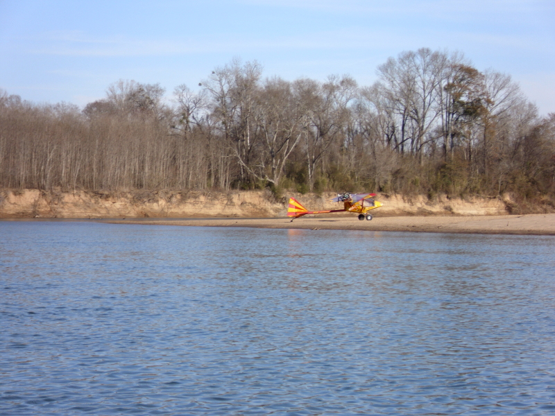

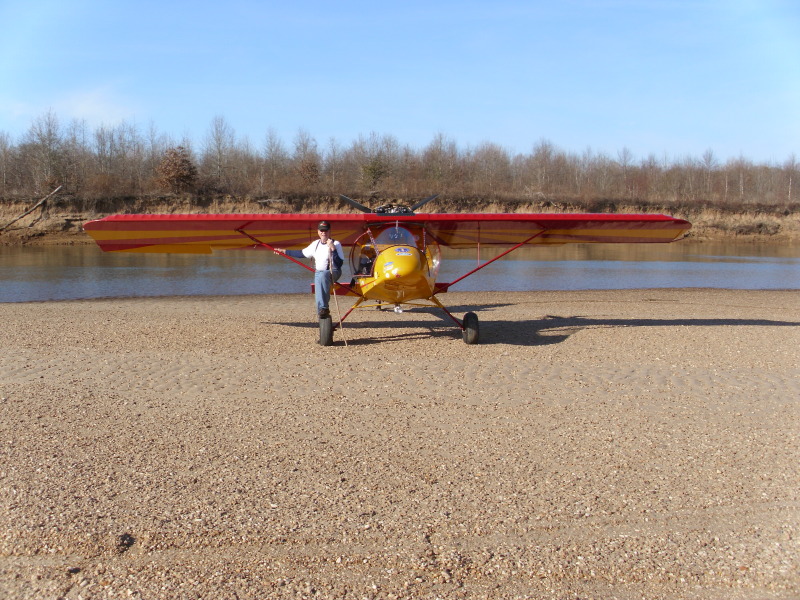

Hi Folks:
I sent some posts to the Kolb List earlier, each with a photo attached. That was
three hours ago. Still no posts.
If I resend, the old posts will arrive.
Hi Folks:
Got to fly a little yesterday, in addition to washing Miss P'fer for the
first time in 9 months. She is 50 lbs lighter now.
Was a beautiful Sunday afternoon, just a little wind out of the NW. I flew
the Tallapoosa River, not far from Wetumpka Airport. My son, Mike, was
going to be running the river in his jon boat. Found Mike and his buddy on
a short, rough sand bar. Too short and rough, I chose a gravel bar up
stream about a half mile. Now that I have the first gravel bar out of the
way, the next one will be a lot more fun and not nearly as intimidating as
this one was.
That was my first off field landing since the first part of last year. I
have only logged 3 hours air time since 10 May 2010.
Does my mkIII fly any better clean? Couldn't really tell any difference.

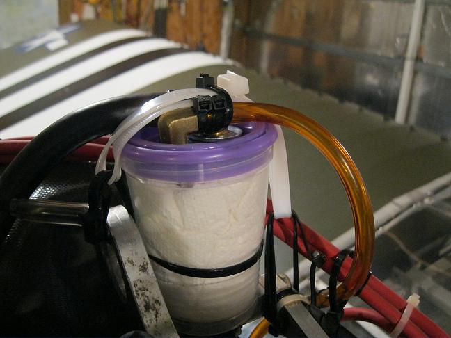

Gary and Thom....
I think you hit the nail on the head with crank case pressure....I thought it
was ok,then I got thinking last night ( I work nights so I had 12 hrs to think
about it ) and I got looking at the videos I made and the dates I made them,then
went to the weather channel and matched up outside temps for the days it flew
and the days it quit and the days it ran good the temps were 32+ and the days
it quit temps were 10 - 18 *.With a closer look today I believe the vent tube
was freezing up blocking off the venting of the case,The original catch cup
I had was loose fitting and starting to come apart so this summer I made a
new one with fittings in the top and a screw on cap for security and it worked
great in warmer temps ,but maybe not so good in the winter months.I will try
to run it tomorrow and will let you know how it goes...It all makes sense now
and why after everything we did it all came back to the same thing !
Thanks Thom and Gary ! I would not have considered this Knowing how simple the
system is...from now on I check this first, fuel pressure will now be monitored
all the time now.... and I should have known this too!
I will let you know for sure tomorrow!
ps...this is the picture of the catch can...i removed the Brillo pad that was getting
deteriorated and replaced it with paper toweling to soak up any moisture

http://forums.matronics.com//files/img_1291_214.jpg
chris ambrose

Is it mandatory to use a large catch can? or can you configure the breather
hose to dump overboard?
Does the engine blow that much oil through the breather? or is the catch
can also the air/oil seperator?
titus, alabama

John,
It's more of an air/oil separator...this is where the moisture gets out of the
engine and without it it would make an annoying mess on the tail...the one I
had on last year had the Brillo pad in it and was not as tight as this one is...maybe
I made it too good !
chris ambrose
http://forums.matronics.com/viewtopic.php?p=327372#327372

| Subject: | Re: Kolb/Jabiru carb overflow |
the engine and without it it would make an annoying mess on the tail...the
one I had on last year had the Brillo pad in it and was not as tight as this
one is...maybe I made it too good !
chris ambrose
Chris A:
Does Jabiru provide an air/oil seperator? or do you have to provide one of
your own design?
Titus, AL
John,
make your own...
chris ambrose
http://forums.matronics.com/viewtopic.php?p=327374#327374
Chris I have installed and flown two of the same Jabiru engines you have
the 2200 I didnt get a big mess out of them and I would run that tube dow
n through the tail boom and out to the end of the rudder it if was making
that kind of a mess on the tail or
I am willing to make you an aluminum Can just for that crank case vent if
you would like with a petcock in the bottom of it so you can drain it on
pre flights
Ellery Batchelder Jr.
