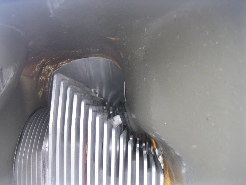

Alright Chris, this thread would not be complete withouth pix and I like pix, so
make sure you take some and show em.
How many baffles did you make per side? Was it a front fence, an upper deflector
and and rear one? I will be making mine this weekend and I plan on only doing
the front fence first and going from there.

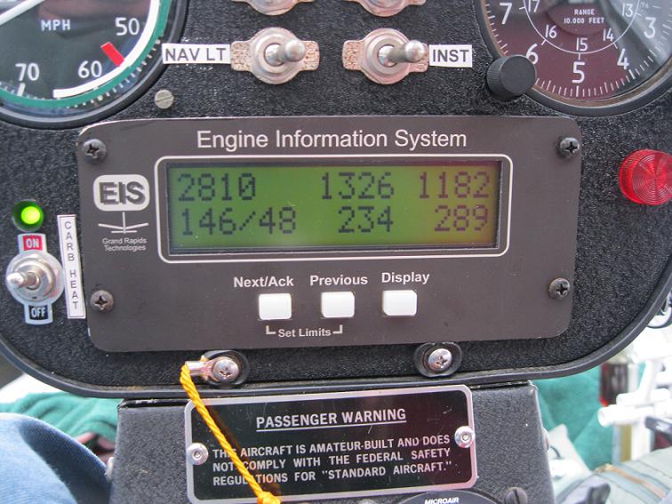

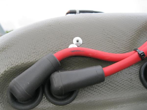

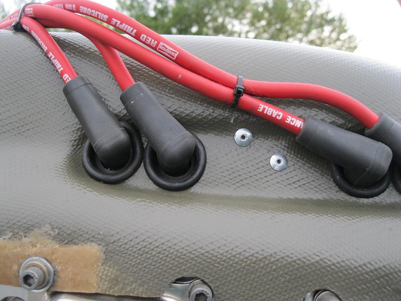

here are some pictures for you....the scoop with the rivits on a steeper angle
is the way you want to do it...at least 45*....the first one ended up being less
than that and although it worked,it didn't work as well as the second one
I did...also it's aimed toward the front of center...
Take a look and I'll try and answer your questions...I haven't put the ones in
the front yet...
chris ambrose
http://forums.matronics.com/viewtopic.php?p=353007#353007

Chris,
In your photo, is your EIS reading 1326 and 1128 EGTs?
If so, that is quite a spread. Are they on opposite sides? If so, you may be able
to get a better balance by tilting the carb bottom (float bowl) about 10 or
more degrees toward the lean side, instead of level.
There is an airflow divider in the intake, oriented vertically, that smoothes the
fuel/air flow before the fuel is completely atomized. However, it also splits
the flow somewhat. The fuel comes into the venturi from the bottom and the
airflow tends to spiral somewhat so one side frequently gets a richer mixture
than the other side. According to Pete Krotje, this can be offset by tilting the
float bowl toward the lean side.

Thom...
I did that and it did help some...the egt's are on 3 & 4 respectively with 4 having
the lowest compression of the 3...(65#)....in your opinion would that make
it lower?? This winter I am planning on cleaning that cylinder up and re ring
it...2&4 were the 2 cylinders that got hot during that mess I went through
last winter when I had the engine stoppage problem..

| Subject: | Re: Thom, Chris or Jabiru owners |
Chris,
Lower compression means lower power but not by much. I doubt that in itself would
mean lower EGT. It is possible you have a valve issue or something else. I
can't remember if your engine is a solid lifter or hydraulic lifter. If solid,
do you adjust them at every oil change? Do you check the head bolt torque then
too? Just thinking out loud.

Thom...
Every 50 hrs...and the clearances have been right on...in fact the last time was
20 hrs ago....and I do think there is some leakage with the valves on that cylinder.
Maybe I'll pull that head and try lapping the valves...
