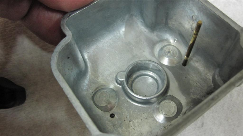

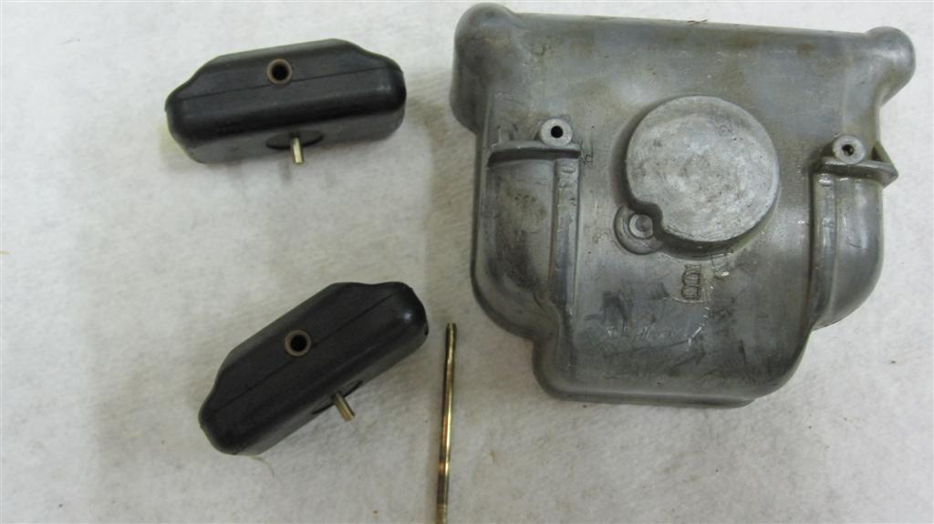

Message 7
| Subject: | Bing Carb Failure |
Happened yesterday, RANS S-7, pilot landed, put the airplane away, went inside.
Came back 2 hours later, 2 or 3 gallons of gas on the floor.
One of the float pins came out and the gas ran out the bottom of the float bowl.
Engine is a 912ULS, serial # is 5648894, carb serial # is 072585, this engine
has approx 150 hours.
The pin is not knurled, it is just pressed into the bottom of the float bowl. Since
a lot of the people on this list use the 912, thought it would be of interest.
Richard Pike
Kolb MKIII N420P (420ldPoops)
richard (at) bcchapel(dot)org
Kingsport, TN 3TN0

Message 9
| Subject: | Re: Bing Carb Failure |
Thanks for the heads up, Richard. Of all the Bing 64 and 94 carbs I've taken apart
I've never seen any indication that these pins were in any way loose. There
is another pin, which acts as a hinge pin for the floats, that goes through
the light gage ss part(11) that the float bears on. This other pin is knurled
on one end so that it stays seated firmly in the cast metal part of the carb body.
The pin I am referring to is labeled 12 in the attached image.
It appears that the pin that fell out of one of the floats in your photo was due
to a manufacturing defect. The float (item 10 in attached image) comes with
these pins permanently installed, or so they should be.
Thom Riddle
Buffalo, NY (9G0)
Kolb Slingshot SS-021
Jabiru 2200A #1574
Tennessee Prop 64x32
Truth is what stands the test of experience.
- Albert Einstein
http://forums.matronics.com/viewtopic.php?p=356230#356230
bowl. Engine is a 912ULS, serial # is 5648894, carb serial # is 072585,
this engine has approx 150 hours.
bowl. Since a lot of the people on this list use the 912, thought it would
be of interest.
Richard Pike

> Titus, Alabama
You are correct, the two stroke is the same design, the float pivot pin cannot
come out as long as the float bowl is in place. But this is a totally different
pin, and it is not knurled, it is tapered where it goes into the float bowl.
I concur with Thom's assessment that this was a bad part. On the other hand,
it would be something easy to check, by dropping the float bowl and giving it
the wiggle test.
Richard Pike
Kingsport, TN 3TN0
Now faith is the substance of things hoped for, the evidence of things not seen.
Hebrews 11:1
http://forums.matronics.com/viewtopic.php?p=356241#356241

Message 20
cannot come out as long as the float bowl is in place. But this is a totally
different pin, and it is not knurled, it is tapered where it goes into the
float bowl. I concur with Thom's assessment that this was a bad part. On the
other hand, it would be something easy to check, by dropping the float bowl
and giving it the wiggle test.
Richard Pike
Sorry, I misunderstood which pin you were talking about.
I think you are talking about the float guide pin. That would ruin your day
is if came loose.
Wonder if the remaining float would work well enough to get back on the
ground with a little power.
Murphy never rests. First time I have heard of this particular problem.
This gent's problem happened on the ground, I assume. Or maybe it happened
in the air and he didn't realize it until he discovered the fuel needle was
not sealing. ????
