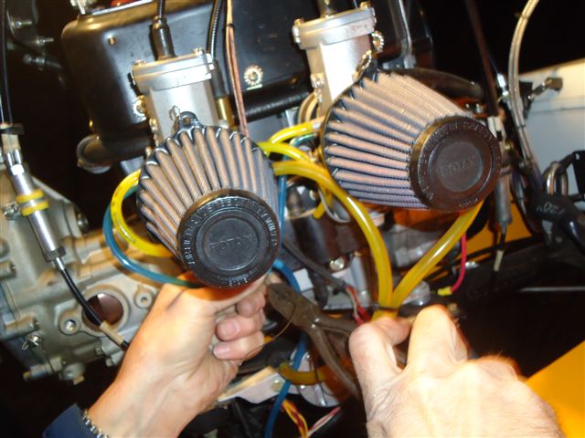

| Subject: | Primer Kit Installed |
503 Rotax Kolb Firestar
[Arrow]
Both optimists and pessimists contribute to our society. The optimist invents
the airplane and the pessimist the parachute. ~Gil Stern
These flying machines are just a fad and will never catch on Unknown
http://forums.matronics.com/viewtopic.php?p=359948#359948
http://forums.matronics.com//files/dsc03384_458.jpg
http://forums.matronics.com//files/dsc03388_199.jpg

Hi Dennis,
Was your 503 hard to start?
Does it also have a choke?
David d.
Kolb Mark IIIX 582 Blue head
http://forums.matronics.com/viewtopic.php?p=359955#359955
Message 4
| Subject: | Re: Primer Kit Installed |
David d.
David D/Kolbers:
Don't think the 503 has choke, but an enricher.
The enricher does primarily the same thing a primer does, shoots a rich load
of fuel into the intake.
There is an enricher jet and an enricher well built into the float bowl of
the Bing carb. With the throttle closed and enricher pulled full on, the
idle circuit is bypassed. As soon as the engine turns over, the contents of
the enricher well are sucked into the engine and the engine will operate at
a richer mixture through the enricher jet. If the throttle is not closed,
the charge in the enricher well will not be sucked into the engine.
If you don't read the operators manual and use the proper procedure the 503
will be difficult to start without a primer in cold weather. However, do it
correctly, and she will crank every time.
Bing uses the same basic enricher system for all the Rotax two strokes and
four strokes.
Personally, I don't want any fuel lines routed into the cockpit.
another thing that helps in cold weather. I pull the enrichener and close
the throttle,,,, then when I do a walk around,,, I hand prop a few
blades... that will empty the enrichener bowl into the manifold and
cylinders. when I get in and start the engine,,, I get a second burst of
fuel, and with everything primed, it starts up extremely quick. the
other thing that helps is make sure the plugs are gaped properly.
boyd
boyd
Boyd Y/Kolbers:
That is a good idea. Glad you shared that with us.
On my 912ULS, if I have a problem starting in cold weather, and so far I
have not had a problem starting with the enricher well below freezing, I
could wait a few seconds with the electric boost pump on to refill the bowl
and the enricher well, then hit it again to attempt to start.
It is better to go to close with the spark plug gap than what the book calls
for, or to wide. The 912ULS calls for .028". I gap for .020 to .025". If
the gap gets too big, it will not fire across them at start up, although it
will run just fine if you luck up and get it started.
Titus, Alabama - 28F and dropping.
boyd
maybe I should explain,,, when I say I pull a few blades... make sure the
ignition switches are off,,, I stand behind the prop arc, then I put my
left hand on the descending blade, and my right hand on the ascending
blade,,, and when I pull it through I do it as quickly as I can,,, I
usually get 3 and sometimes 4 compression per pull. I have used this
method to start the engine when the battery was dead.
boyd y

my firestar with the 503 now starts very good with a pull starter...some
people convinced me to do away with the enricher and use a primer which I
did...the 503 starts the first pull when primed correctly....and I keep it
running at times with the primer until it is warmed up...however my original
problem with starting in the beginning was bad plug wires and carbs not set
up right. I now I sort of think that with everything correct the enrichers
should do the job and have some advantages...for what it is worth....jim
swan just put the firestar away for the winter.....lots of snow up here
now... another thought I suspect the enricher may need maintence more often
for proper seal if used...
