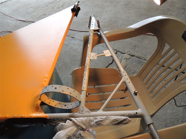

> From: Ellery Batchelder Jr <elleryweld@aol.com>
> here is a PIC of the tail post supports that I think John Hauck came up wit
> h the tail wheel is much better than that Pizza cutter and it does make it
> handle more like a tail dragger
> Ellery Batchelder Jr.

Thanks for the photo Ellery.
I beefed up to a thicker aluminum wall tubing and a larger and thicker steel welded
gusset and it's all covered up......
I've put it to the test and it seems to have done the trick.
Both optimists and pessimists contribute to our society. The optimist invents
the airplane and the pessimist the parachute. ~Gil Stern
http://forums.matronics.com/viewtopic.php?p=381224#381224

Message 7
| Subject: | Re: Tail Post supports |
in your pic you dont have the supports that show in my pic, thicker aluminu
m tubing will not help the area of failure you had better take another look
at my pic the supports I am talking about are attached to the big Ring tha
t slips over the end of the tail boom tube under the elevators attachment p
oints and attach to the bottom tube that your tail wheel rod slides into th
is will help this vertical Tube from breaking under side load pressure

Message 8
Ellery,
I respectfully disagree. The non-turnable Pizza Cutter tail wheel puts a side torque
on the lower tail-fin midway, so when forced into a tight turn, it will
break, where as a swivel wheel eliminates this problem.
Take note where mine broke in two places. I don't believe your concept would offer
any solution to this, because you are reinforcing it in the wrong location.
Hope this photo helps clarify things.
http://forums.matronics.com/viewtopic.php?p=381274#381274
http://forums.matronics.com//files/two_fractures_101.jpg

Message 10
Dennis
I have never seen that kind of breakage. I have to ask if plane was built
to specifications. My MKIIIC has a fairly strong .125 wall bottom tube
that has in most Kolbs kept that kind of breakage from happening. Normally
we see side loads causing the problems Ellery has described the fix for. I
have had the turning bogie wheel and now the locking/swivel tail wheel on
my MKIIIC both of these wheels can produce the side loads that can cause
long term failure of the tail post without the fix.
Rick Neilsen

Message 11
Thank You Rick I have just repaired my second Tail post on a different kol
b in the same place and this is no longer a problem area with the side loa
d supports just my experience but results may differ from other views

Message 12
Thank You Rick I have just repairedmy second Tail post on
a different kolb in the same place and this is no longer a
problem area with the side load supports just my experience
Kolbers:
We can thank Dan Horton, one of my flying buddies, for
coming up with the tail post fix. Can't remember how many
times we repaired and modified my mkIII tail post until Dan
came up with the idea of adding external bracing. Haven't
had any problem with mine since.
Sargents, Colorado
