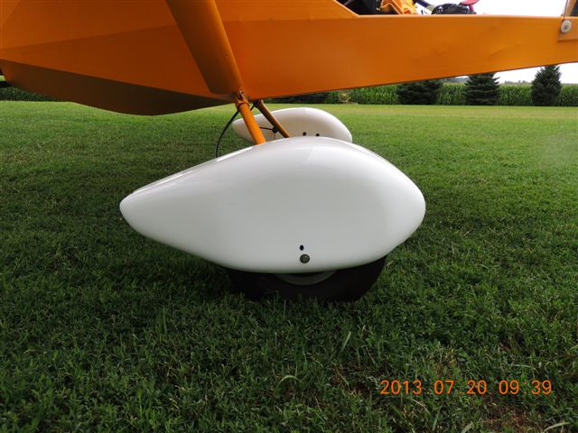

Wheel fairings are often called "wheel pants", "speed fairings" or, in the UK,
"wheel spats". These fairings are a trade-off in advantages, as they increase
the frontal and surface area, but also provide a smooth surface, a faired nose
and tail for laminar flow, in an attempt to reduce the turbulence created by
the round wheel and its associated gear legs and brakes. They also have the important
function of preventing mud and stones from being thrown upwards against
the wings or fuselage, or into the propeller on a pusher craft.

wow! who would have thunk it? This must be something new?
