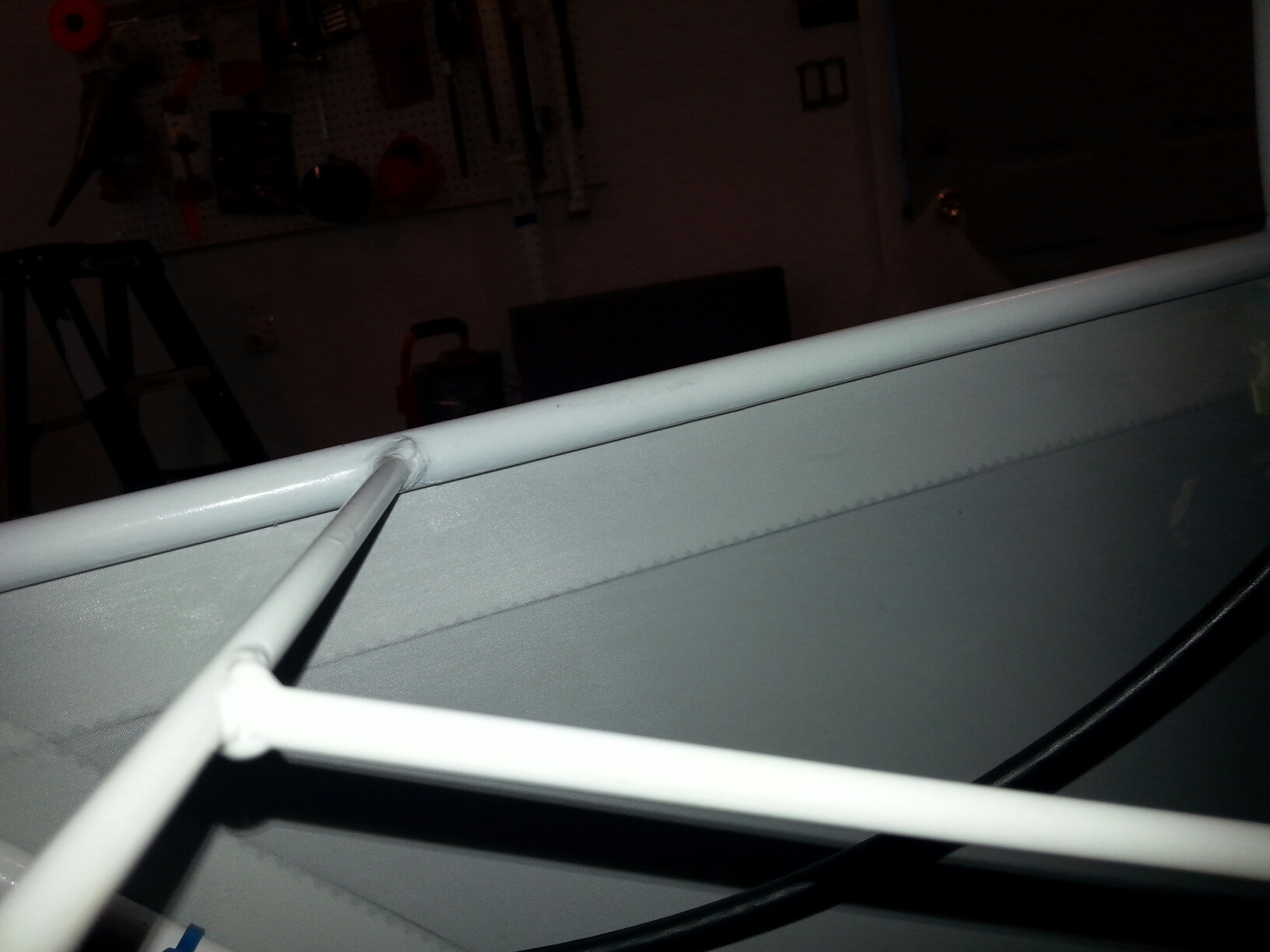

Stuart, the following may help when you cover the wings.
One of the reasons I chose to build the Firefly is the strong airframe, however
as well designed as it is the uncovered ribs aft of the main spar are a bit
flexible. You may find they are bowed and not perfectly parallel , I x braced
them using rib stitch cord and that got them very close. After covering the
wing and marking reference lines I found the rib apex was still slightly off.
I bought several lengths of square hardwood at Lowes about 1/2" and 2 or 3 medium
plastic spring clamps with plastic or rubber jaws. Made a nylon hook on the
end, reached thru the root end of the wing, hooked the rib and pushed or pulled
it into position and then clamped it to the 4130 structure of the root rib.
Riveted that rib and then moved on to the next. Ended up with nice straight
ribs and rivet lines.

Well now that is another very helpful hint. Thank you for posting it.
I will be sure and look this over real well before I do my covering.
I had wondered about the X-bracing in the wings. I remembered doing this on
the Chief, but I think we tacked it down to each rib so they would not move.
The ribs were wood and the fabric was not glued to the ribs. We used rib
stitching that duplicated the original configuration.
I noticed in the Poly Fiber manual it says to not tie or fasten the
X-bracing to the rib so that the rib was free to move, but it also states
the purpose was to keep the rib in place. Well, which is it? When I think
of X-bracing, I think of floor joist or side walls of a hangar. The purpose
is to keep things from "racking" and getting out of alignment. I would
think the same applies to ribs, so wouldn't you want the bracing attached to
each rib to prevent movement?
My guess is the bracing would be halfway between the main and rear spars?
Any and all input from the list about this is most appreciated.
however as well designed as it is the uncovered ribs aft of the main spar
are a bit flexible. You may find they are bowed and not perfectly parallel
, I x braced them using rib stitch cord and that got them very close. After
covering the wing and marking reference lines I found the rib apex was still
slightly off. I bought several lengths of square hardwood at Lowes about
1/2" and 2 or 3 medium plastic spring clamps with plastic or rubber jaws.
Made a nylon hook on the end, reached thru the root end of the wing, hooked
the rib and pushed or pulled it into position and then clamped it to the
4130 structure of the root rib. Riveted that rib and then moved on to the
next. Ended up with nice straight ribs and rivet lines.

Thanks Russ, and John H,
It did not make much sense about X-bracing that lets the rib move (not tied
as per Poly Fiber manual) and then fasten the rib to the fabric to make it
stay in place.
Careful rib alignment in.
X-bracing out.
I am still thinking about rivets vs. stitching, but am leaning towards
stitching (thanks for the videos guys) since I already know how to do it and
I don't like drilling holes.
Planning to order my supplies tonight.
I am sure there will be more questions along the way.
Thanks again,
Stuart

Stuart, One, to reach the full strength of the fabric, it must be shrunk at
350 degrees. There are exceptions to this that are covered in the Poly
Fiber Manual.
All overlaps, tape requirements, everything is in the Manual.
If you want to save weight there are three colors of Poly Tone that have
the silver and require no Poly Spray. From memory, these are Nevada Silver,
Rancho Silver, and Piper Trainer Blue. This is covered in Appendix A of the
Manual along with reasons to NOT do as you're considering and skipping the
Poly Spray coats.

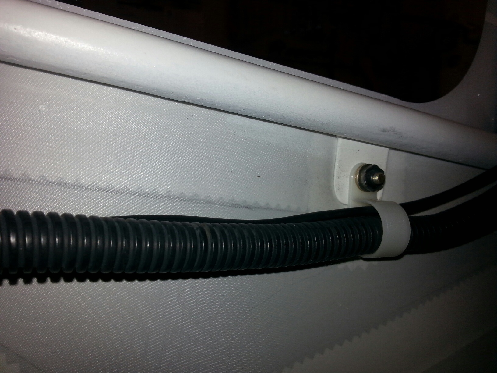

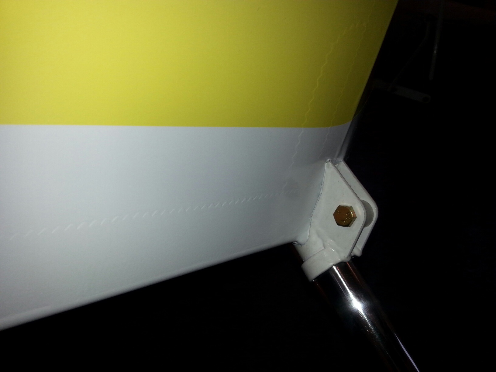

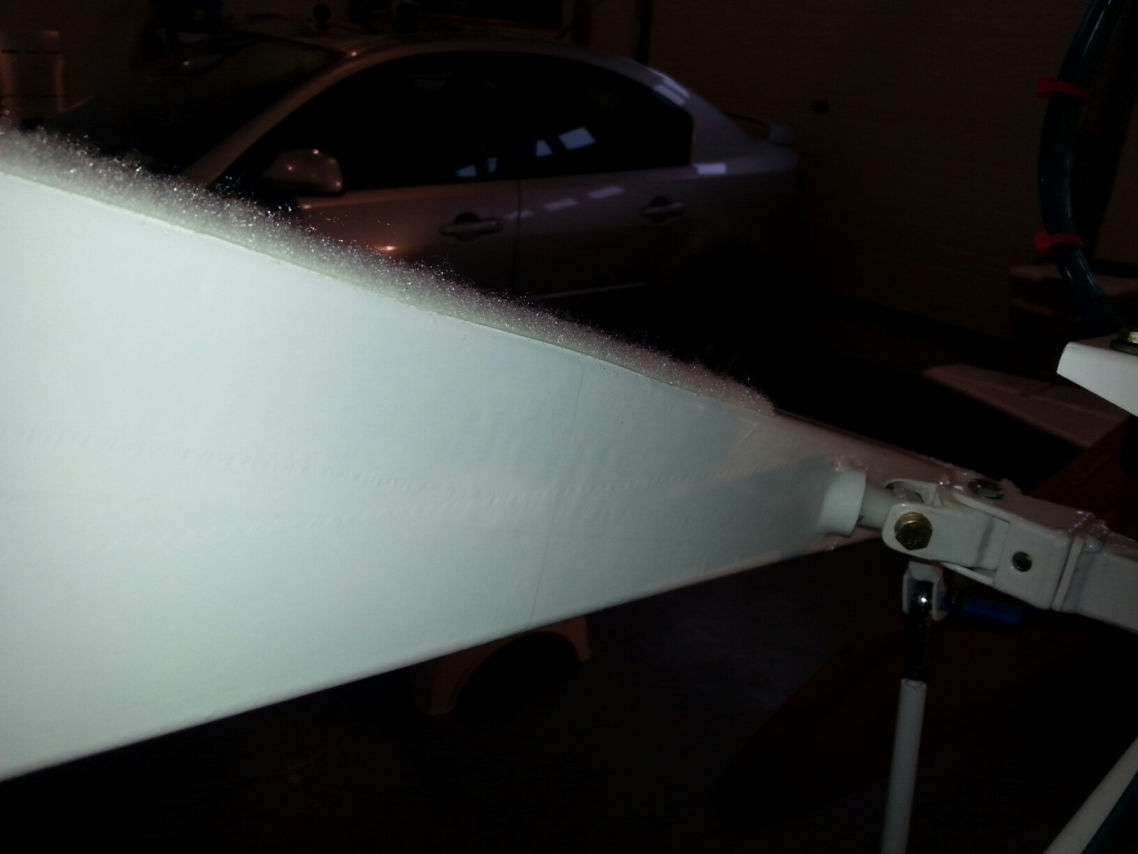

> Stuart, here are the close up photos you requested.
> I used the Poly Fiber system, it truly is a very simple system and the
> instruction book is quite good. The only part I had any trouble with was
> estimating the initial application tension, it is somewhat subjective
> depending on the size of the item being covered. 1 coat poly brush
> brushed,
> 1coat poly brush sprayed, 3 coats silver and multiple color coats. If I
> were
> to do it over I would not paint a lightweight plane white. I was used to
> auto paints and was quite surprised at how little coverage the pigments in
> the Poly Tone provide. The cage and boom are powder coated and most other
> parts such as nose cone, flaperons, tail ring and such are single stage
> Croma One auto urethane.
> http://forums.matronics.com/viewtopic.php?p=417577#417577
> http://forums.matronics.com//files/20140125_124446_resized_212.jpg
> http://forums.matronics.com//files/20140125_125707_resized_180.jpg
> http://forums.matronics.com//files/20140125_124949_resized_181.jpg
> http://forums.matronics.com//files/20140125_124840_resized_642.jpg
> http://forums.matronics.com//files/20140125_124800_resized_959.jpg
> http://forums.matronics.com//files/20140125_124700_resized_158.jpg
> http://forums.matronics.com//files/20140125_124627_resized_929.jpg
> http://forums.matronics.com//files/20140125_124544_resized_108.jpg
