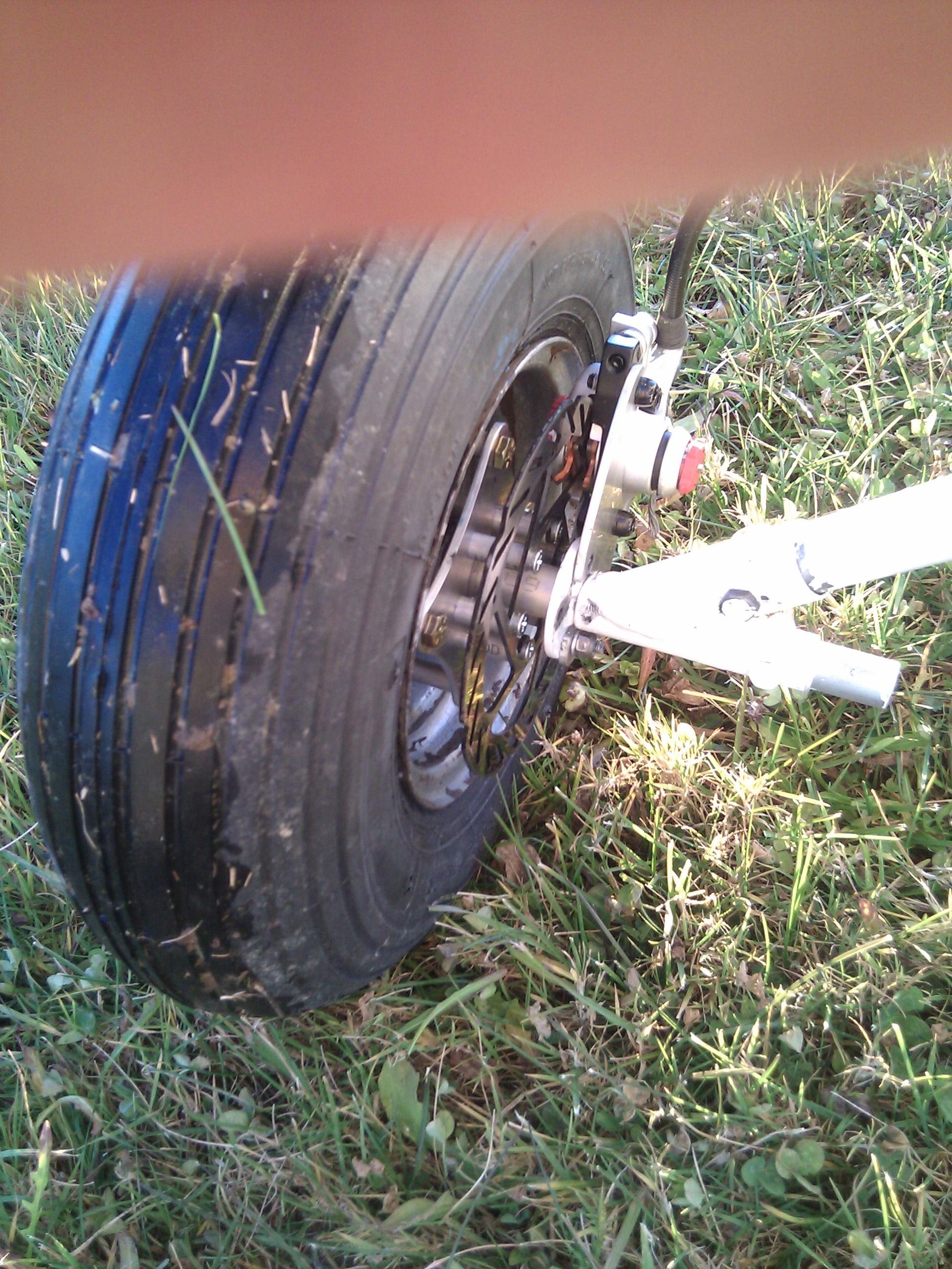

I put these on my Firestar. They work great. One finger will bring me to a screeching
halt.
They are cable activated bike brakes.
Avid BB7 Road Disc Brake 140mm x 6 Bolt
I hope you can see what I did there. I had to make two brackets out of aluminum.
One bracket plate has the four bolts going through the rim on one side and
six bolts holding the rotor on the other side. I switched to narrower tires
to make this work. I may have been able to use longer bolts but I like the way
this came out. The second bracket is for the caliper to mount to. I thought
three bolts on the axle plate would work but I couldn't get a bolt through there
so it is held on with just two bolts and is plenty.
The nice feature of these brakes is that the individual side pads can be adjusted
easily with your fingers.
