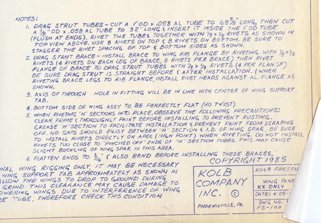

What is the(desired) length of the rivets that are used to fasten
the drag strut gussett to the spar tube? There is the plate thickness,
the spar tube thickness and the H section thickness to deal with...
Obviously I can call my buds at Kolb tomorrow...but would like to
order tonight...Lots of Stainless 1/8th rivets on ebay...and yes I know
I can always use overly long ones... Herb
ps rebuilding the Firestar wings that I got from Rev. Pike...

maybe this helps,
I have a complete set of plans and the book for Firestar
West1m

here is another pic
West1m
