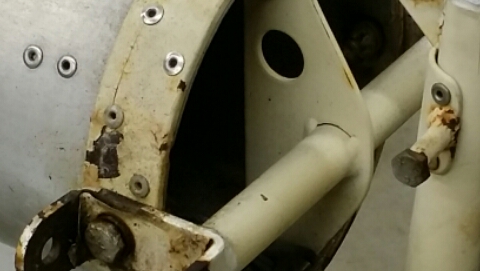

Message 4
| Subject: | Re: Removing bolt from elevator control mechanism |
Testing I think I got it?
2007 Firestar 2 503 N203SD
Moster 185 flattop PPG/Sky K2 Paraglider
Trike Buggy Soaring Trike & Northwing Stratus XP
http://forums.matronics.com/viewtopic.php?p=443071#443071
http://forums.matronics.com//files/20150605_082838_751.jpg
Message 5
Looks good to me. When in doubt, or testing, put "do not archive" somewhere
in your message. That way it won't tie up Matt's computer space.
Bill Sullivan
Windsor Locks, Ct.
FS 447

Message 25
Talking to Travis...He indicated that motor mounts cost 45 bucks each..
$180 the set.
Here is my solution. I noticed that the Trike that I bought had the
two part rubber style...and having a box of those...I decided to make
use of them on the Firefly...Just a square of 6061 with 4 holes and a
large hole to accommodate the rubber through mount.... I have new ones
but managed to use some older ones , will change them out later on. Free
vs 180 bucks...I can handle that...
Frugal Herb
ps first pic shows the 503 mounted on a trike frame...second shows one
of the Firefly mounts...
> each.. $180 the set.
> the two part rubber style...and having a box of those...I decided to
> make use of them on the Firefly...Just a square of 6061 with 4 holes
> and a large hole to accommodate the rubber through mount.... I have
> new ones but managed to use some older ones , will change them out
> later on. Free vs 180 bucks...I can handle that...
> Frugal Herb
~3/8" bolts?

| Subject: | Re: motor mounts |
7 dollars and change at Aircraft Spruce....37 and change for a set
including shipping...
