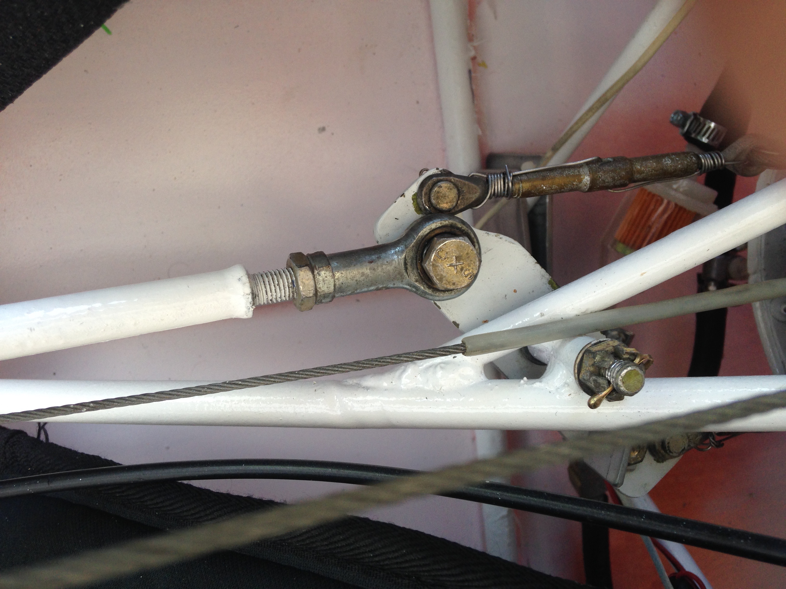

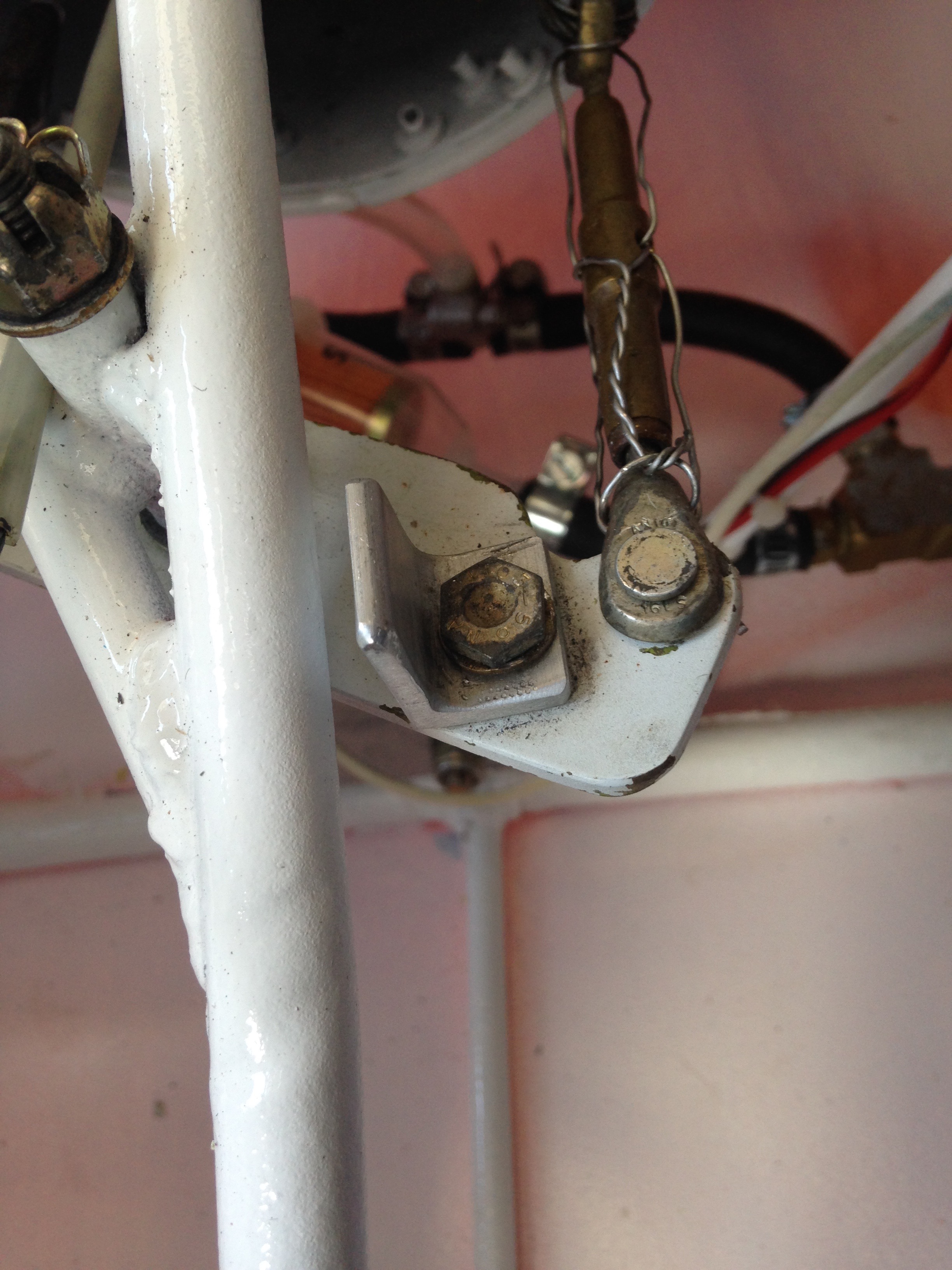

Dee, Is yours an early Mk III? Is there a serial number on the aft end of
the engine mount tube? I ask because the bell crank to which the elevator
cables are attached is not the latest version. Is the cable that appears in
this picture: http://forums.matronics.com//files/img_1190_880.jpg the trim
cable? Does it run all the back to the elevator bell crank at the elevator?
Rick Girard
PS If that is a paper fuel filter you ought to consider replacing it with
one that has a synthetic element. Rotax has a service bulletin that
recommends against using paper elements. If you get ethanol gas there is a
possibility that water held in suspension by the ethanol can saturate paper
element and effectively block the flow of fuel.

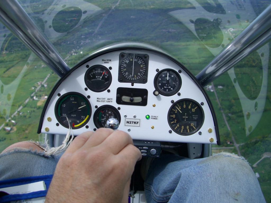

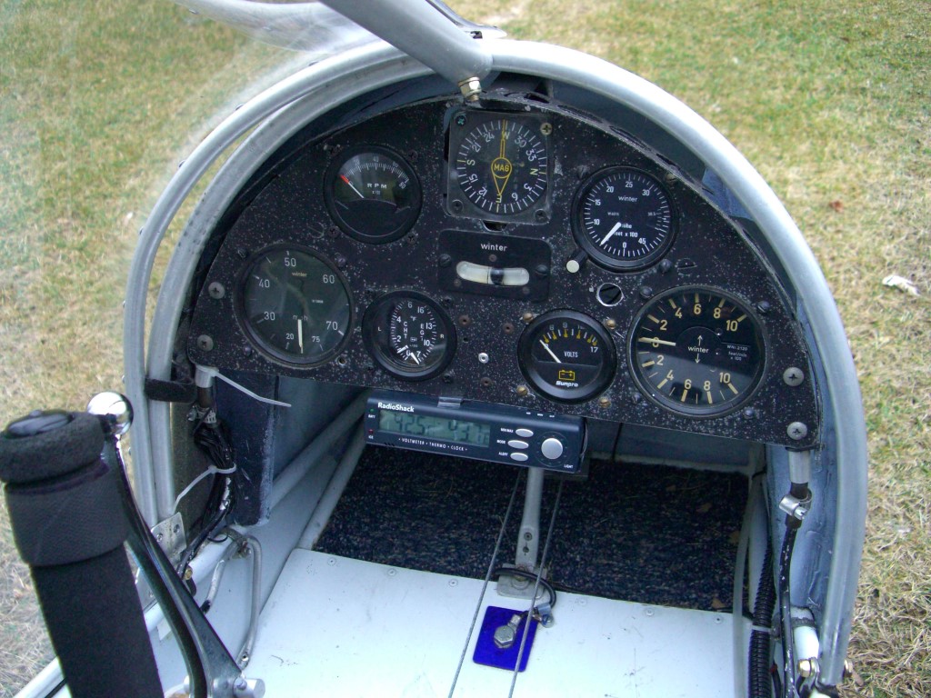

Here is my new panel and my old panel on my Firestar. Don't paint it white. Big
mistake. Reflects too much off the lexan.

Yes, it=99s a early (old) Mk3. There=99s no SN on the aft
end of the engine mount tube. There are two cables shown in the photo.
The one in the foreground (the one out of focus) is one of the rudder
cables. The other cable (with the plastic sleeve) is the trim cable that
goes all the way back do the elevator horn.
