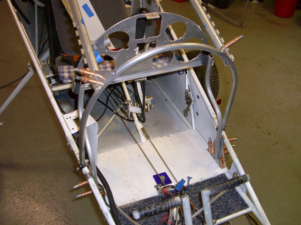

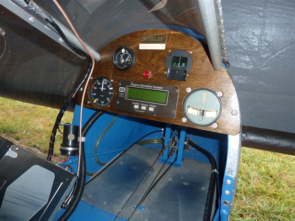

This is how I did it. The panel is attached to a rubber hose at the bottom. The
top rests against the nose cone. This allows the nose cone off by itself. Not
attached to the panel at all. Yes you lose a little shin room. Just be sure
to account for that. I rounded off the panel at the bottom so I didn't cut my
legs off in a crash.
Two things I would do differently next time around. The compass needs to be vertical.
The panel should be painted black.
Scott Olendorf

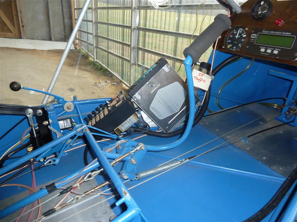

I agree with what Larry says here. (Even if Scott Olendorf's panel setup is extremely
cool)
It is really easy to make the panel on the FSII slide out a bit; notice that the
wood has holes drilled in it and the windscreen tubes fit through it. You remove
one screw on either side and the panel will slide up the tubes about 8 inches,
plenty of room to get access to the back side.
Radio Shack is out of business, but the little black box with all the switches
on it has lots of room for all your wiring needs. Probably other electronics shops
sell similar boxes.

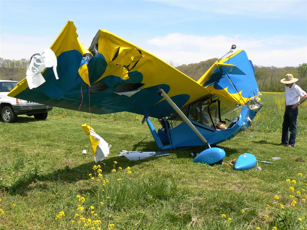

One more thought: if you do extend the panel back toward your shins, make sure
it is not rigidly attached to anything.

> The only thing on my cockpit that I need to do anything with is adjust the
> altimeter. I do that on the ground. The rest of the controls that I need-
> tank selection- fuel pump, strobe, ignition switch are all located in
> various spots that are within reach.
> Primarily what I am saying is that you can position every thing that you
> need in spots that allow you to reach them while seated and flying. It just
> takes some thinking on your part. However you are the one that will be
> flying it, your choice, but give it some serious thought. I have a small
> center console in front of the stick that holds my radio, all my switches-
> plug ins for the intercom. HAC man system on the left side by the throttle,
> fuel selector switches on the gusset to the left of my seat. Take a poll
> and see how many have moved their console out.

>> Mcabbage wrote:
>> > I would like to extend my fs2 Inst. panel
>> > .S N I P .
>> > Mike
>> Being one who must remain conscious of leg room, I would be careful how
>> deep you make your extension and/or the top to bottom measurement. Too
>> much in either of these dimensions will cut down that leg room. Looking at
>> the inside shot of the pictures you posted, there's not much room between
>> the pilot's shins and the bottom edge of the extension.
