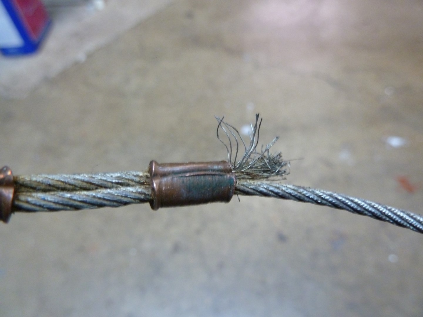

Had a set of used rudder & elevator cables that we are going to be using in the
Firefly, they are in good shape except that the ends are pretty ratty. How to
trim them off without taking a chance on nicking them?

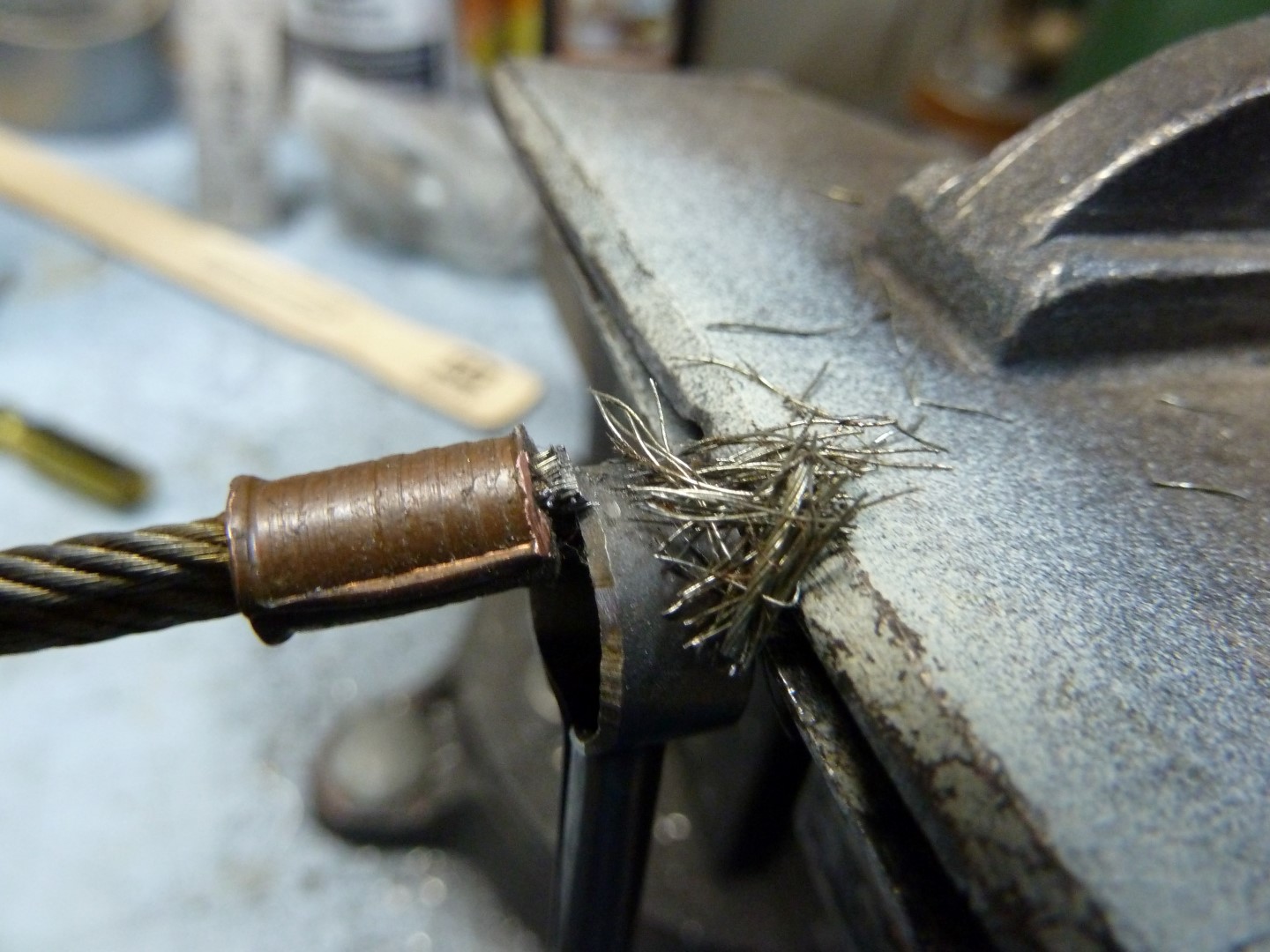

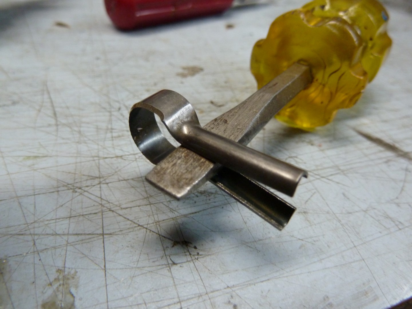

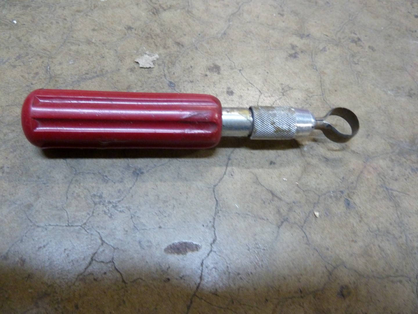

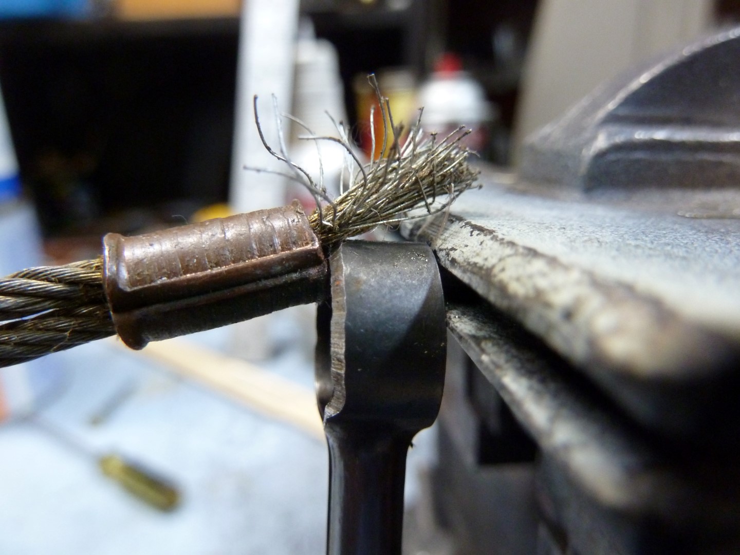

Use a round x-acto knife blade. Used a screwdriver to spread the blade tang so
it would slip over the cable. Work the tapered edge up against the swedge. Clamp
the sheet metal vise grips in the vise, used them to hold the cable, and hold
the blade tight against the swedge. Used the cut-off wheel on the Dremel and
buzzed off the raggedy wires.
Easier to do than tell about. Did all four wires in about ten minutes.
