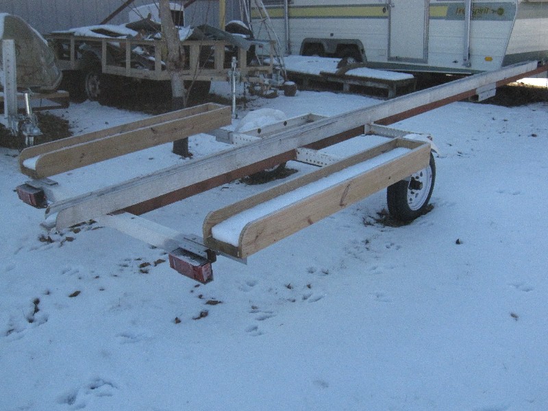

Having owned, built and flown a twinstar. I'd say that I'd try find somethin
g fully enclosed. That being said, if you could put the cage and stuff like t
he engine, etc. in the pickup bed? The wings could be transported in good wi
ng rack, wing facing forward towards the truck. Should really pad and cover w
ell. If damage a wing it will be really bad news. Attached is a picture of m

Thanks for the pic; looks just like what we RV-x guys use for our wings.
Are you saying that the rack pictured would be adequate for road
transport of the wings? Are the leading edges strong enough to support
the wing weight on a couple of 8-10" wide carpet strips? If so, that
would simplify my task considerably. The rest of the stuff I can deal
with, but the wings concern me. I was envisioning something more like a
couple of heavily padded shelves as big as the wing(s).

My money is on the boat trailer. I brought home a Quicksilver from Wichita (to
Saint Paul, MN) using a boat trailer and later brought home my Firefly on a boat
trailer from New York. I think it cost me more in tolls than gas!

Message 12
| Subject: | Re: road transport question |
My T-18 trailer actually looks a lot like that, except the axle is farther
aft to support the weight of the T18's Lyc engine.
Thanks for all the suggestions; I'll likely head down there with a stack
of 2x4's, several sheets of plywood, and a trunk full of pads & foam sheets.
Charlie
