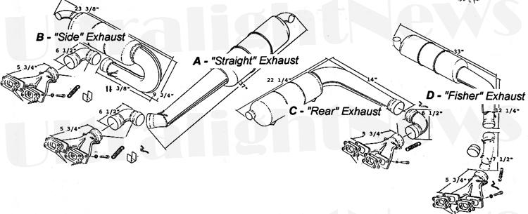

We would like to change the muffler configuration: if anybody has a Rotax straight
exhaust expansion cone (A- "Straight" Exhaust in the attachment) and you
want to sell it, let me know.Would also consider a "C" exhaust as in the jpeg.
