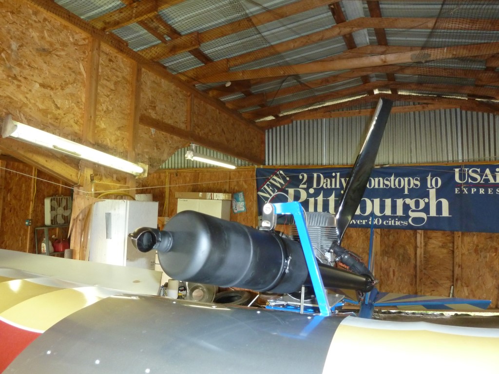

The vibration is now 99% GONE. Over 5,000 rpm it is as smooth as the 582 on the
MKIII, between 5,000 and 4,600 you can feel it just a little.
The support bracket is welded to a base that is clamped securely to the the beefy
end of the spar carrythrough. Rubber hangars are the usual ones from Advance
Auto Parts. I got the tapered cone from Jegs hot rod supplies for $33. A lot
cheaper than getting one from Rotax... The length for the cone came from an old
LEAF catalog, used the muffler inlet diameter & exhaust ball socket outlet
diameter to claculate the cone length & taper, must have got it right, it runs
perfect and the EGT's are good.
This whole rig might actually be just as light or lighter than the original hang-it-off-the-head
arrangement. Surprisingly it is not any noiser.

Can't call that one a tail pipe. More like a head pipe.
