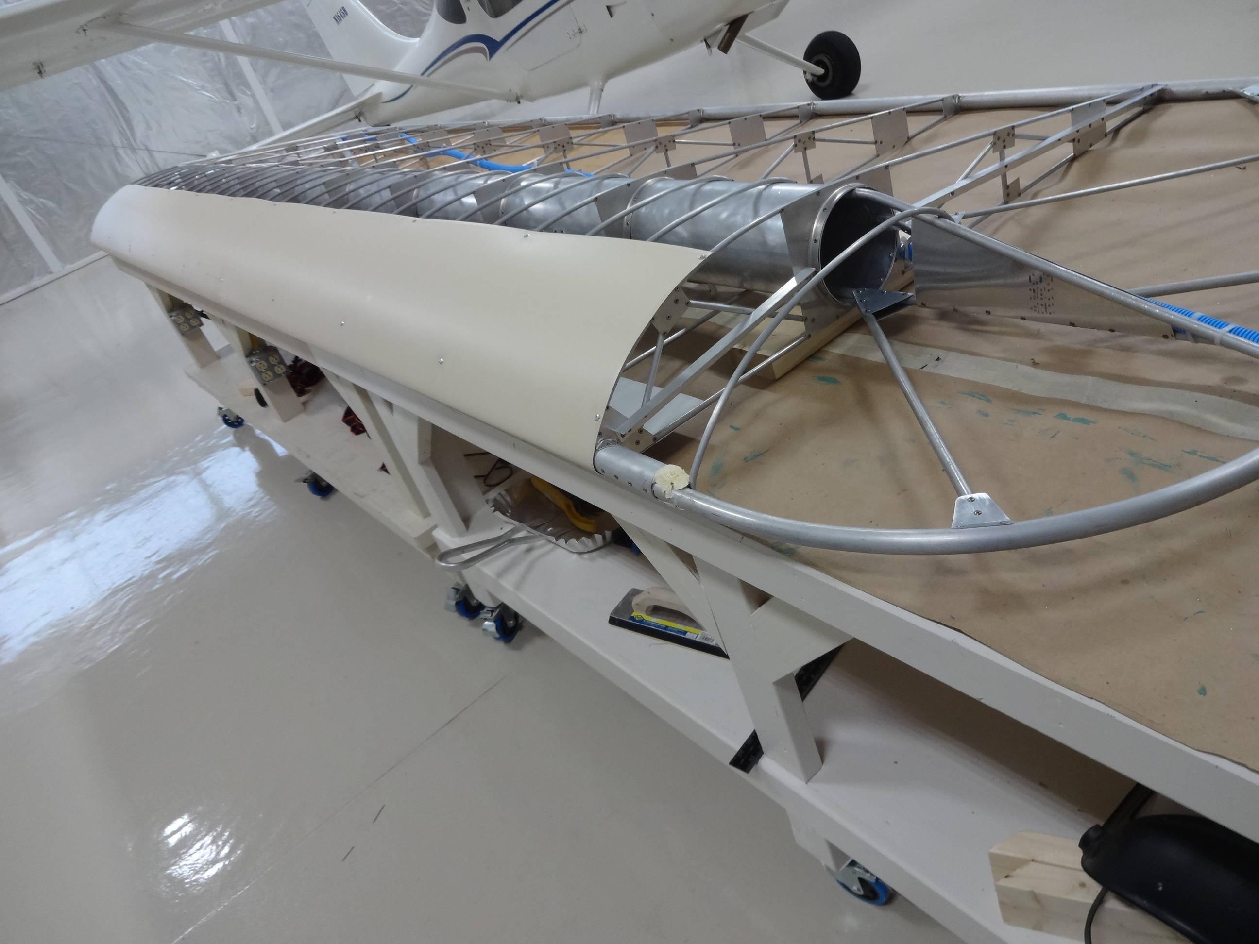

Mike, The great thing about experimental aviation is that it's perfectly
okay for you to make this mod. I don't know if it will get you any benefit
but it will be your airplane and should stand out from other Mk 3's. Can't
wait to hear how she flies.

The wing also gets very rigid when the fabric is cemented on, shrunk, and
doped. I have no idea how much strength the fabric adds, but it does attach
all the parts and compresses them together. How much pressure? I don't
know, but enough to start bending tubes if one gets overzealous. Most of my
leading and trailing edges are bent. I like tight fabric.
