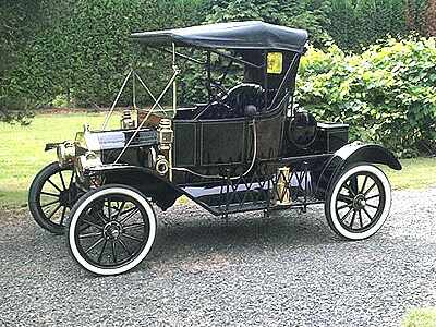

I am sure that someone besides me has noticed this but when I finally got around
to looking at the magneto on the Jabiru, what a surprise to see that the design
was the same as used on the Model T Ford. My Ford will be 97 years old in
March and as far as I know the magneto as never been touched other than to have
the magnets re-magnetized. This says a lot about the reliability of the design.
Walt Mefford :D

Hi Walt.
Interesting info. Just wondering if your Model T was the first car you
bought "new".
Have a Great New Year,
Buz

Buz,
Actually I am the fourth owner. My father was the third, a friend of
the family was the second and I don't know who the first was. Not that
old yet. However, my grandfather did not give up flying until he was
91.
Walt

Here is the car. Now I need the lightning.
http://forums.matronics.com/viewtopic.php?p=221958#221958
http://forums.matronics.com//files/1912ford_461.jpg

Nice looking T, Walt, very nice.

Yep, a photo with the T and the Lightning together showing how far personal
transportation has come in 100 years is what would be appreciated for the
newsletter. (I think I remember the first Ford Model T came out in late 1908
however, I was NOT alive when that happened).
