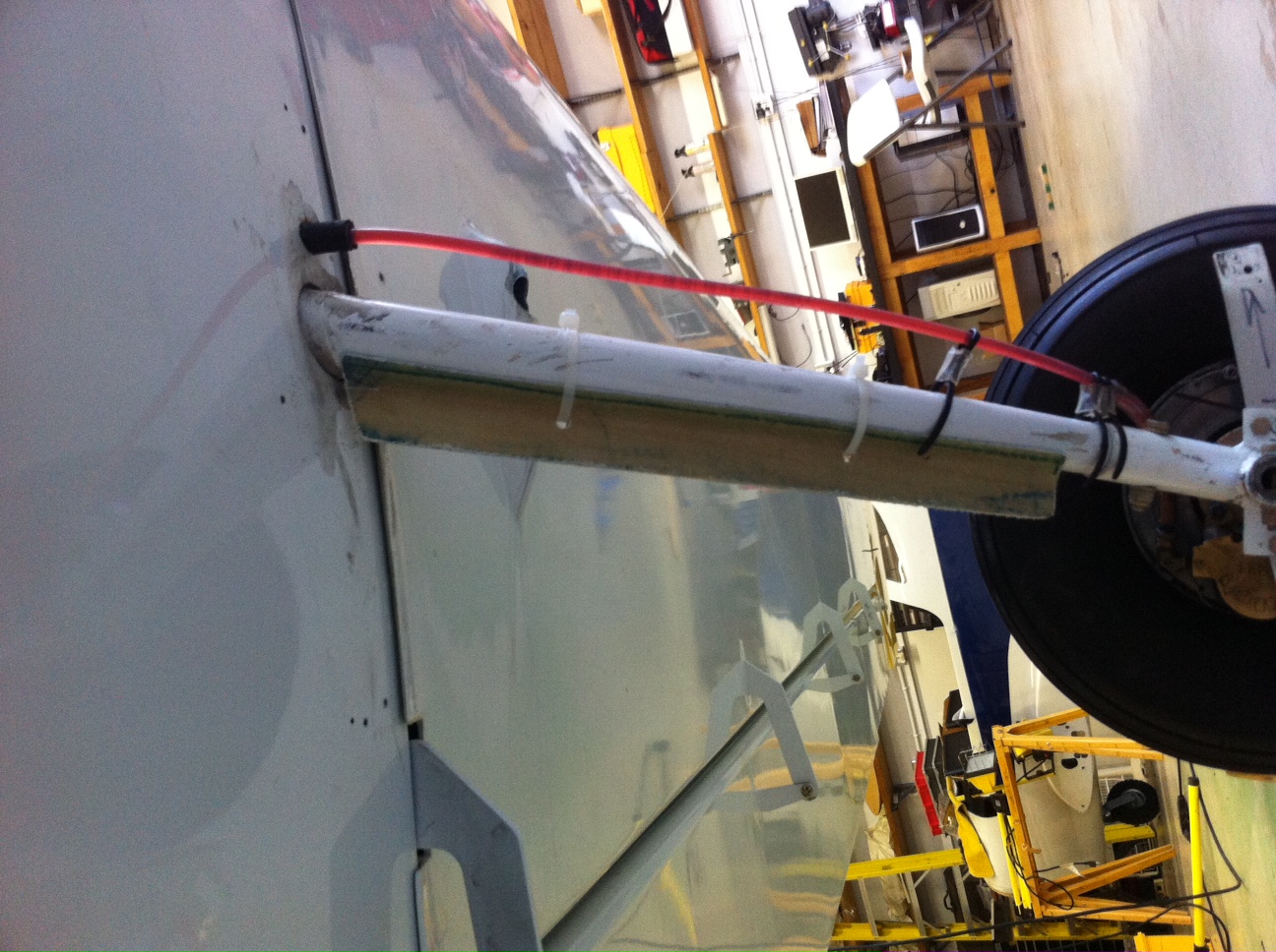

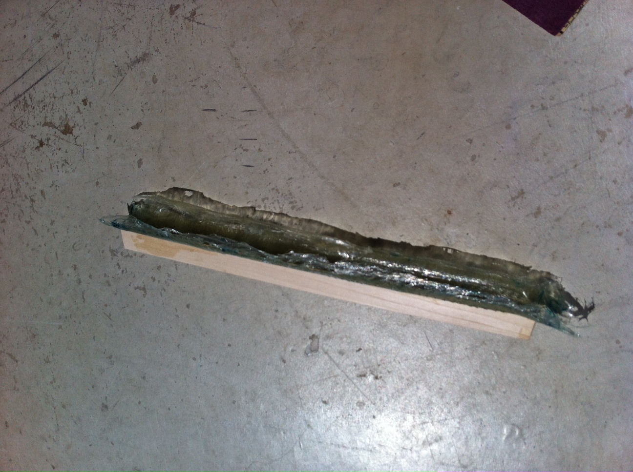

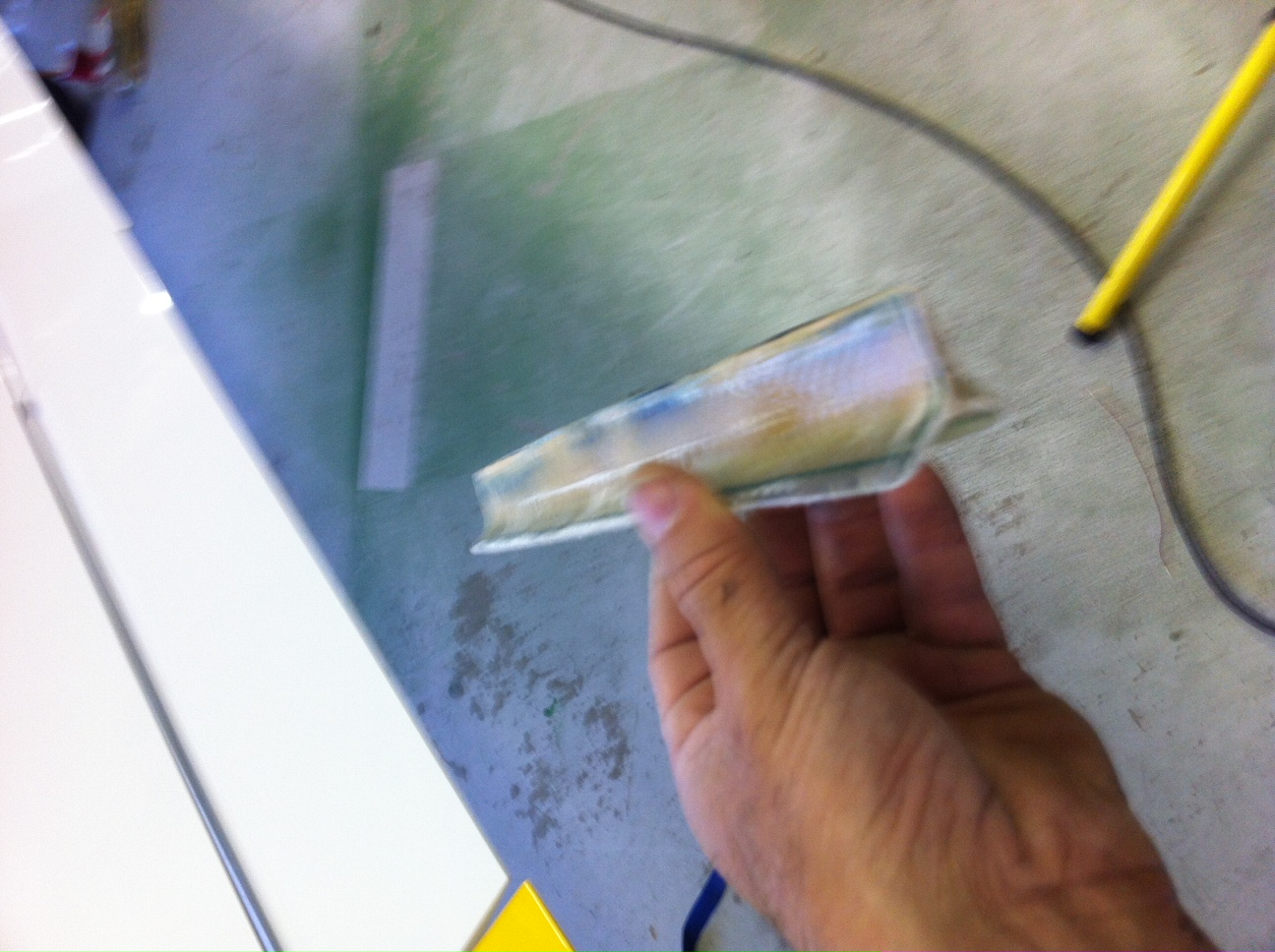

It would be nice to see some pictures of the stiffener as you built it and
as you complete the installation.
Dennis

Hey, I've talked about this before, haven't I? I've had 3 big changes I wa
nted
o make for a long time: 1) Fix fuel distribution issue. 2) Make some sh
ort
ingtips. 3) Eliminate the landing gear shimmy.
I installed the flow straightener tube and vanes that Nick sent me about a
year
go. That did an amazing job. Perfect? No. Good enough that I'm not
onsidering installing fuel injection? Yep. So #1 is adressed.
I still need to make short wingtips, but my passenger yesterday asked "Why
does
t shake like that after you land?" GRRRRR.
So I bought an axe handle and started chatting with neighbors here on the
irport about cutting and shaping it. I figured I'd buy a 1.125" ball cutte
r
nd put a radius in it. Kept putting that off because it didn't sound like
fun.
Then it hit me: I really just need it stiffer in fore/aft flexing. And
hatever stiffener I make needs to glue to the gear leg so it needs to be a
very
ood fit. Nothing fits better than fiberglass built in-place!
I decided I would tape off the gear and lay up 3 laminations of 7oz cloth
irectly onto the back of the gear leg. I did that tonight, and it's curing
omorrow I'll sand the back of that and use some flock and 5 minute epoxy to
ttach a 1/8" thick piece of balsa wood that extends about 1.5" behind the g
ear.
nce that's cured I'll lay up about 6 layers of cloth on both sides of the
alsa, overlapping onto the section that's on the gear. So the gear shouldn
't
nd up much stiffer since it only has 1/8" thickness between the 6 layer
amination, but it should be SUPER stiff across the 1.5" section.
So I should get that done tomorrow, and let it cure overnight. Then I'll p
op it
ff the gear, trim it, and glue it onto the landing gear leg.
Any thoughts? Nick, any suggestions on the best adhesive to attach to the
gear?
hould I remove the paint or glue to the paint?
When I glue it I'll put a couple of zip ties around it to hold it while it
ures, and leave them on just in case it ever comes loose.
Fingers crossed, I can report in a few days that I have eliminated the dang
himmy once and for all.

Hi Dennis, I don't think you could stick anything to a gear leg that
wouldn't come off when the leg flexed. Where wood has been fitted before
wasn't it held on with hose clips?
To hold the wood in place without hose clips I would have thought you
would need to 'bandage' it on with fibreglass tape. As you say, good fit
and glued but held all along so it has to flex with the leg.
For sticking things to aluminium there is a primer chemical, nasty
stuff, I don't know what it's called, some kind of chromate maybe, needs
painting on and curing with heat.
Interestingly I have Lighting gear legs on my Esqual but no shimmy, even
with the great big RV spats (which I took off, anyone want to buy
them?). Different wheels and brake discs though.
Just about to fit 6 ply tyres so maybe that will change :(
Good luck, regards, Clive
nted
to make for a long time: 1) Fix fuel distribution issue. 2) Make some s
hort
wingtips. 3) Eliminate the landing gear shimmy.
year
ago. That did an amazing job. Perfect? No. Good enough that I'm not
considering installing fuel injection? Yep. So #1 is adressed.
does
it shake like that after you land?" GRRRRR.
airport about cutting and shaping it. I figured I'd buy a 1.125" ball cutt
er
and put a radius in it. Kept putting that off because it didn't sound like
fun.
whatever stiffener I make needs to glue to the gear leg so it needs to be a
very
good fit. Nothing fits better than fiberglass built in-place!
directly onto the back of the gear leg. I did that tonight, and it's curin
g.
Tomorrow I'll sand the back of that and use some flock and 5 minute epoxy t
o
attach a 1/8" thick piece of balsa wood that extends about 1.5" behind the
gear.
Once that's cured I'll lay up about 6 layers of cloth on both sides of the
balsa, overlapping onto the section that's on the gear. So the gear should
n't
end up much stiffer since it only has 1/8" thickness between the 6 layer
lamination, but it should be SUPER stiff across the 1.5" section.
op it
off the gear, trim it, and glue it onto the landing gear leg.
gear?
Should I remove the paint or glue to the paint?
cures, and leave them on just in case it ever comes loose.
shimmy once and for all.

Hi Dennis, I missed your message re. gear shimmy. When does
it occur, can you isolate it as far as main or nose
wheel? Bob Haas S/N 00071 N330BH.

Hi Dennis, I don=99t think you could stick anything to a gear leg
that wouldn=99t come off when the leg flexed. Where wood has been
fitted before wasn=99t it held on with hose clips?
would need to =98bandage=99 it on with fibreglass tape. As
you say, good fit and glued but held all along so it has to flex with
the leg.
stuff, I don=99t know what it=99s called, some kind of
chromate maybe, needs painting on and curing with heat.
and as you complete the installation.
Dennis

Here are a few pictures.
Attachment5, the 3 layers on the landing gear (covered in tape) before I pried
it off this morning.
Attachment8, the half-tube of fiberglass once it was pried off.
Attachment7, I went with 1/16" X 1" bass instead of 1/8" balsa, attached with 5
minute.
Attachment6, a shot down the length of the tube. Once I've laid up several layers
on both sides and trimmed it, it should flex okay in one direction, and be
super stiff going against the 1" length of bass/fiberglass.

Okay, the stiffeners are built. I'm waiting on an adhesive test I did to choose
which adhesive I use to bond them to the back of the gear legs.
FWIW, they're stiff. I can barely flex them in the direction the landing gear
SHOULD flex, and they won't budge in the other axis. Makes sense. Hopefully
they're not TOO stiff. Somewhere in there is a joke about being 18 again, but
I'll skip it. :)
Here are two pictures.
