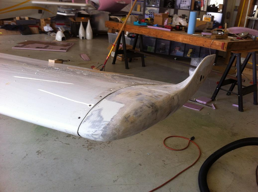

Finally forced myself to do this. Step one, layup 5 layers of cloth or tape on
the taped off old tip, cover with peel ply and let cure. That gives a great
starting point for the mounting flange. If you're not making them removable,
skip that step...but you need some flange to mount to the wing. The black lines
on the white wingtip are my alignment lines to make the flanges.
Once that was done, I measured out 18" from the inboard end of the tip, which is
almost exactly where the tip begins it's upsweep into the winglet, and cut off
the tip and winglet.
That tip will be much shorter than the end of the wing, so you'll have to split
it and mount the two halves to get started, which can be see in the second picture.
The flange I made in step one is inside the wing end, and I've already
bonded the new tip to that flange.
And I see now my pics are out of order. I'm sure it can be figured out. I'll
make a separate post for each pic from now on.

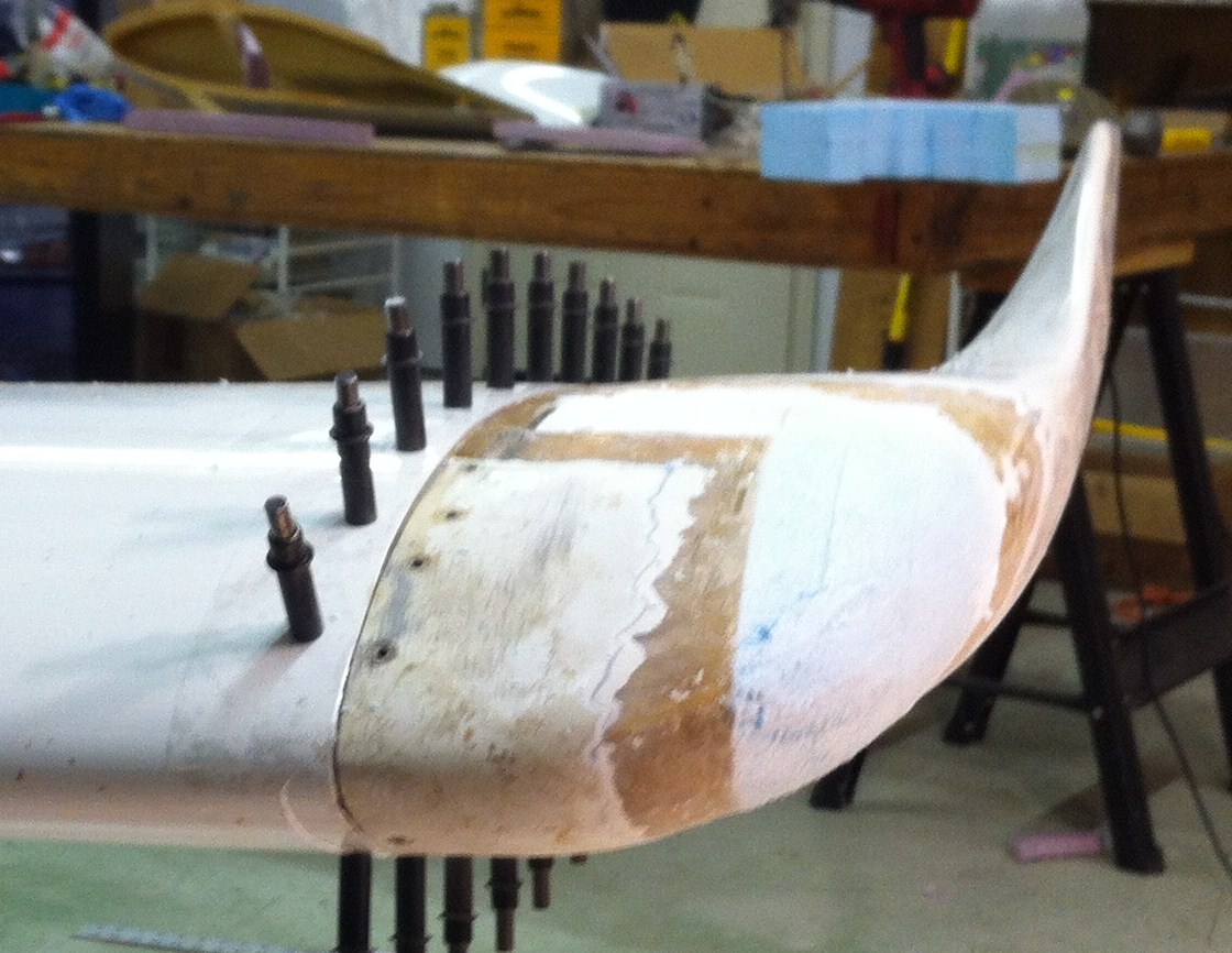

Once the tip is bonded to the flange, make sure it's aligned with aileron and drill
and cleco the flange in existing mounting holes. Then fill that big gap
with some foam and prepare to get artistic. This tip was the one I tried to do
the first time about 2 years ago, which is why it's so mangled. I decided it
was easier to cut off the parts I was unhappy with previously, so there's more
foam here than on the other tip.
Yes, I'm using cheap insulation foam. It doesn't really matter since it's A) not
structural and B) not going to stay there!
http://forums.matronics.com/viewtopic.php?p=384620#384620

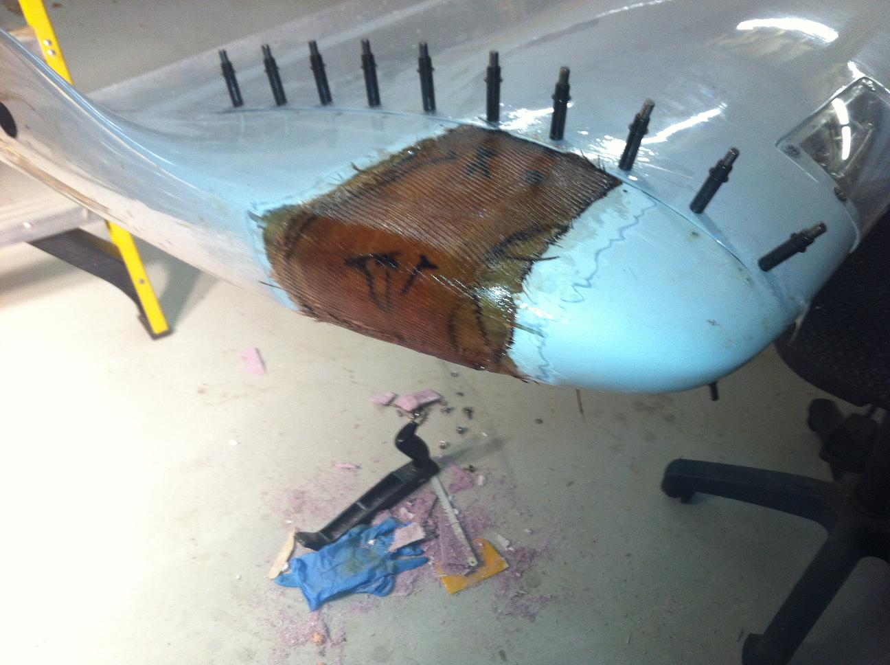

>From the previous pic, the foam had a flat spot, so I added a bit more foam and
then sanded to this final shape.
http://forums.matronics.com/viewtopic.php?p=384621#384621
http://forums.matronics.com//files/img_2233_105.jpg

2 layers of glass over the foam, showing the Right wingtip now, just happens that's
the one I took the picture of.
http://forums.matronics.com/viewtopic.php?p=384622#384622
http://forums.matronics.com//files/img_2245_727.jpg

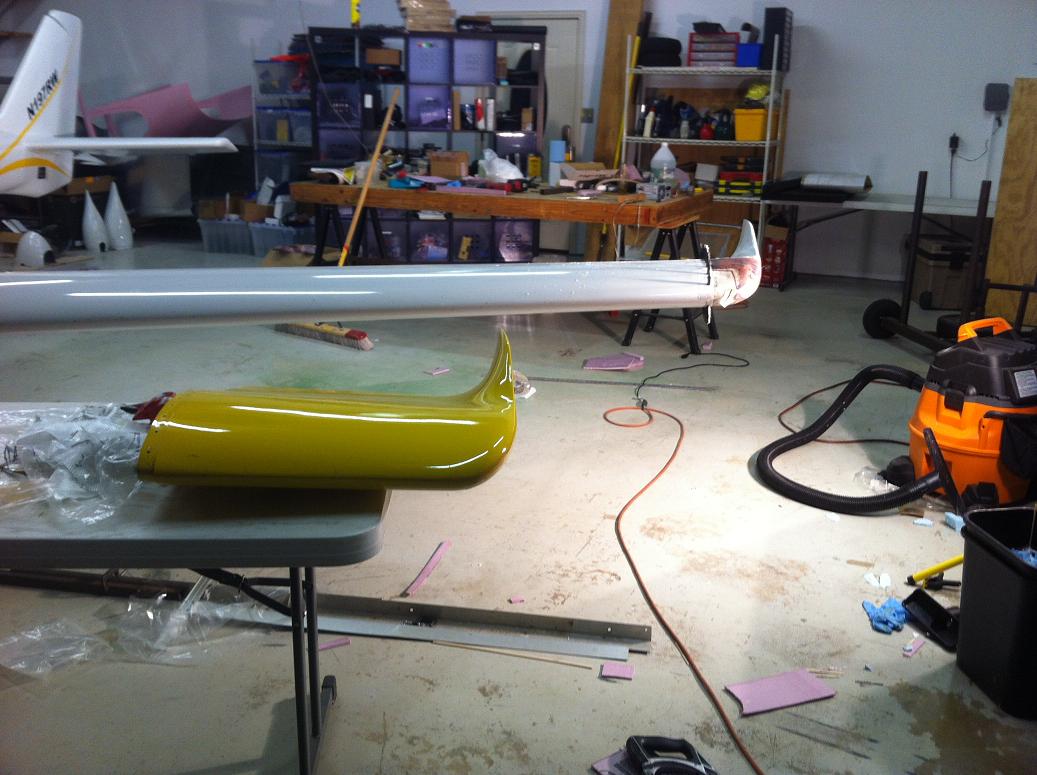

A quick shot, showing the original long tip (yellow) in foreground, the new shortened
tip on the plane, and following that diagonal line, the long tip from which
the short tip was chopped off sitting on the table on the back wall.
http://forums.matronics.com/viewtopic.php?p=384623#384623
http://forums.matronics.com//files/img_2252_163.jpg
