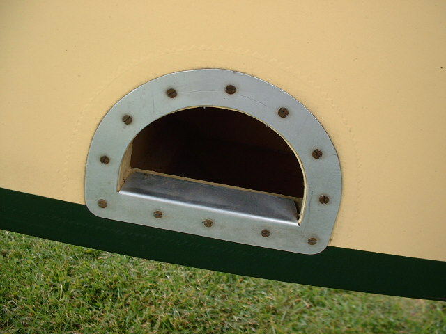

--> Pietenpol-List message posted by: "Oscar Zuniga" <taildrags@hotmail.com>
Peter (from Down Under) wrote-
>Check out http://www.pjshenton.go-plus.net/default.htm.
Yes, the 3/4" x 3" reinforcement is addressed there... and so much more.
For example, I know I've seen several Piets with nice steps, but here's a
great photo that says it all:
http://www.pjshenton.go-plus.net/pictures/Dscf0020.jpg
