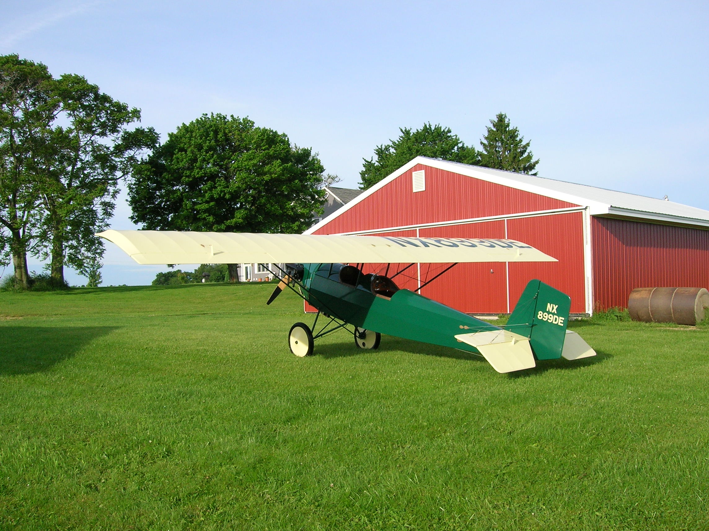

      --> Pietenpol-List message posted by: "Don Emch" <EmchAir@aol.com>
      Hello,
      I have the long fuselage with the split axle steel gear with 19" spoked wheels.
      This makes it taller than some.  Luckily I have really long legs( 36" inseam
      ).  This makes for about a 15 deg angle in the three-point.  11 to 15 degrees
      is quite a difference between airplanes that are basically the same.  Yet all
      the flyers seem to describe similar landing characteristics.  Mr. Pietenpol used
      different wheels and landing gears and from what I could find never really
      advised against one combination.  It just shows the docile nature of the airplane
      and the adaptability of using what is/was available.
      Don E.
      NX899DE
      http://forums.matronics.com/viewtopic.php?p=46132#46132
