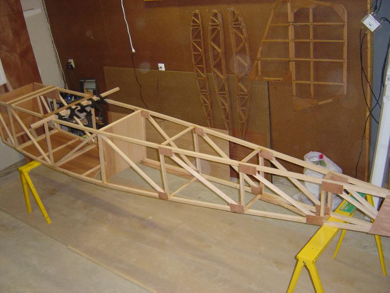

Everything cleaned up nicely and I did almost all the gusseting before
moving it.
http://www.subarubrat.com/misc/pietfuse4.jpg
Message 6
| Subject: | Re: Victory over exploding airplane |
VERY nice!
