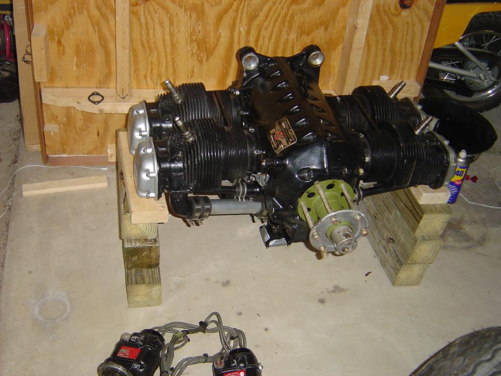

      Picked it up today after a 10 hour round trip,  A65-8 130h SMOH with two
      mags, prop hub, and carb. I need to ferret out a few things, eyebrows,
      aircleaner assembly, and I am sure a few small items. I need to fab up
      my exhaust system and need to do some research on carb heat and other
      such details.
      http://www.subarubrat.com/misc/Pietengine.jpg
       -Scott

      Scott; I looked at the photo of your A65.  that piece of junk is dangerous
      and you should never fly behind it in a Piet or anything else.  Get rid of
      it immediately.  I'll give you $150 for it right now!  ;o)
      The engine is the heart of your Piet, isn't it?  You build the boat, the
      gear, the tail feathers, the controls, even the wings- but it doesn't have a
      heartbeat until that engine is in your hands.  When that mass of metal comes
      into the shop, even before you tighten the bolts that hold the engine mount
      to the airframe, flight suddenly becomes possible!
      I love engines.  They are big, heavy hunks of metal but they are the hearts,
      too.  I love the smell of exhaust, and fuel, and oil, and all of that comes
      from the engine.  Mind you, the higher plane of this feeling is when you
      have a radial engine, but a pancake four will do just fine for everyday,
      too!  And considering that the engine represents probably half the cost of
      your airplane (if not more), when you have that piece and the prop safely in
      the shop, you're looking at little piddly costs from then until the end of
      the project.  You're over the hump.
      Good on you, Scott.  Put the heart in your airplane and you will be so much
      closer to flying!  The heartbeat will be ready as soon as you hook that fuel
      line to the carb and the ignition switches to the mags.  From there, it's
      downhill and the next thing you know, you'll be lining up on the runway
      centerline with the throttle ready to go full forward.
