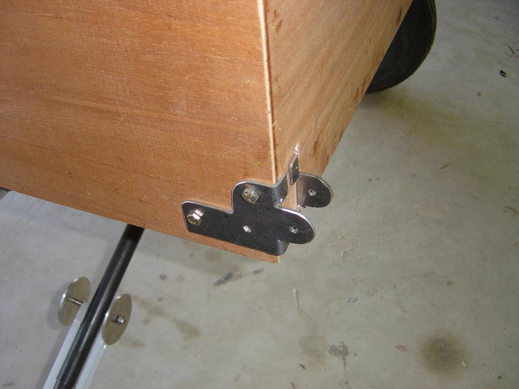

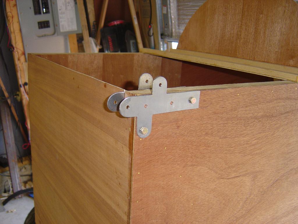

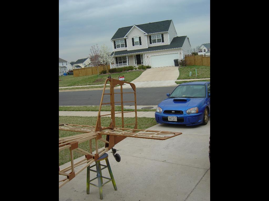

Message 15
| Subject: | Join the EAA? And more progress |
I was looking into the EAA, and I suppose it varies on a chapter by
chapter basis, but what sort of benefit have piet builders seen from the
EAA? What in general could one expect from the EAA? Broad questions but
about the best I could think of.
I also got a fair ammount done in between allot of other efforts this
weekend. The tail fittings got finished and the tail is on. I also got
the plane side motor mounts done but got sort of stonewalled on the
motor mount itself.
Upper mounts
http://www.subarubrat.com/misc/pietmar31a.jpg
Lower mounts
http://www.subarubrat.com/misc/pietmar31b.jpg
Tail on
http://www.subarubrat.com/misc/pietmar31d.jpg
Elevator work
http://www.subarubrat.com/misc/pietmar31e.jpg
http://www.subarubrat.com/misc/pietmar31g.jpg
-Scott
