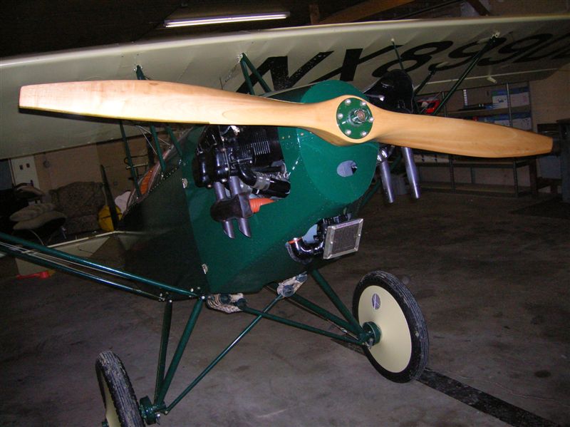

Message 14
| Subject: | Re: A 65 exhaust |
Gene,
I didn't use a muffler. I just made up flanges and went to my local muffler shop
for 1.5" mild steel tubing and weld up some straight stacks. Added a carb
heat muff to the right side.
Don Emch
NX899DE
http://forums.matronics.com/viewtopic.php?p=136664#136664
http://forums.matronics.com//files/pietexhaust_180.jpg
Message 15
Gene,
The heat muff is 3" diameter exhaust pipe. It has two 1.5" holes drilled through
to slide up the two straight pipes and welded in place. The back side of the
muff is closed off. A tube is welded into the side with a duct attached and
running to the heat box. I heated and somewhat squared off the front of the
muff to try to get about the same area of inlet as outlet. Let me know if you
would like more pics.
Don
