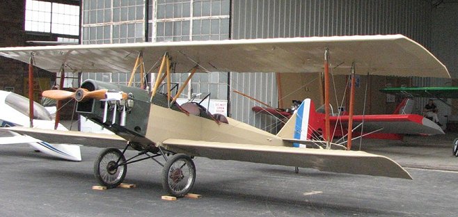

| Subject: | Re: Piet biplane |
Hi,
The biplane conversion doesn't change the top wing much, far as I can tell. The
St. Croix/Aeriel plans essentially add a lower wing that attaches where the lift
struts would, the low wing has ailerons that are actuated by rods from the
high wings ailerons. Not positive without looking again, but I think the struts
from the end of the lower wings to the upper ones attach at the same point
as the lift struts normally would.
http://forums.matronics.com/viewtopic.php?p=141840#141840
