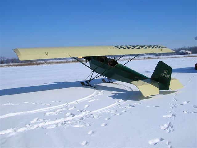

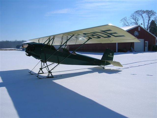

Don,
Please do post details regarding the ski design. I bought an old pair of wood
water skis with the thought of making them into snow skis some day by stripping
the paint off, maybe adding a layer of fiberglass and making a mount similar
to what you show. I guess it should work. Do you notice any balance differences
between the skis and wheels? I've wondered about that....
Your Piet looks great on skies. Thank you for sharing. Have fun.
john e
----- Original Message ----
From: Don Emch <EmchAir@aol.com>
Sent: Sunday, February 24, 2008 8:54:22 PM
Subject: Pietenpol-List: Skiing
Just thought I'd share a couple of shots of my day spent skiing today. Just when
I thought I had as much fun as I could have with the Piet I borrowed these
skis from Frank Pavliga. What a ball! I think I'm going to try to copy these
skis. When I get some measurements made up I could share them with others if
interested.
Don Emch
NX899DE
