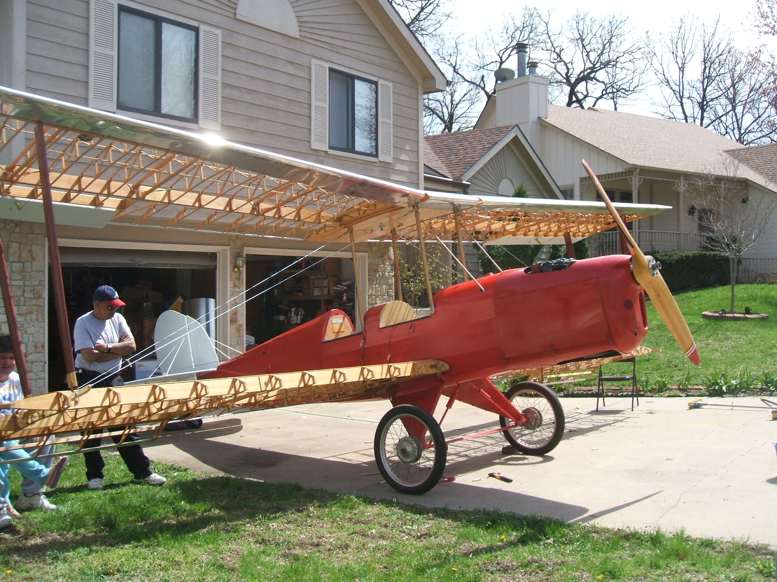

      Thanks guys,
      I had similar thoughts, but am still bugged by the fuselage really looking long
      in front of the wing.
      My engine is supposed to weigh 315 pounds, which if it was short and close to the
      firewall (like the radial in the prototype Aerial) it wouldn't be that much
      of a concern, the model A wet is about 280. My wood prop is only about 15 lbs,
      so it isn't really far out of line.
      However it is pretty far forward. There is some lead in the tail and the preliminary
      W&B seems okay. With the tail up in a flying position it still has a good
      deal of weight on the tail, about 50 pounds I think (need to get scales and
      weigh it, but it doesn't seem nose heavy on the gear.)
      In the air I don't think there would be an issue. The gear's camber is off and
      that is what originally concerned me, however there is quite a bit of adjustment
      that can be done, so until I have the plane up off the ground where it can
      be adjusted, I don't know that it has any real camber problem either.
      The Aerial plans have a few guidelines, essentially that if the engine is 280 lbs
      or more move the top wing forward a few inches, and that the distance between
      the wings can be set to 51" without appreciable differences in the W&B to make
      entry/exit easier. From measuring the plane with the wings on, those changes
      were made. The plans don't have anything about relocating the landing gear,
      as the idea was to minimize changes from a stock plane. To get clearance from
      the gear the lower wing mounts lift the wing a couple inches above the mount
      points (which are the same mount points as the lift struts on a normal Piet or
      GN-1.)
      With the engineering math info I should be able to get an idea of whether its a
      concern or a real problem, and the magnitude of what it will take to sort it
      out.
      Thought about replacing the two giant magneto's with a CDI system for instance,
      that could cut at least 30 lbs off the nose, and would add a small battery that
      could be moved behind the CG point. If it was just a little off that kind of
      thing might help. (Probably cut more than that, was told the brass conduit for
      the plug wires weighs almost 15 lbs., the mags look like starters for a big
      truck, they are huge.)
      But if it needs the gear forward a foot or so, its  going to take some real work.
      To me it looked like you could slant the gear forward like a Bucker Jungmann,
      and gain 6-8" of forward movement of the axle pretty easily. The A&I disagreed
      and said it would double the landing shock load, which led to a discussion
      that I didn't follow well (neither did his friend that was with him that built
      a Kitfox and was pretty knowledgeable.) So I will look toward a good engineer
      if it comes to it.
      The A&I is maintains a biplane museum, has 30+ yrs experience and specializes in
      tube/rag work, and is one of our local EAA tech counselors, so I am inclined
      to take his advice and investigate if I have a problem.

      Jim,
      I just had a peek at the photos of your plane at westcoastpiet.com .
      That IS a long nose (on your plane). I've never seen one in person, and
      there aren't many photos of Aerials floating around, so I have no idea
      whether yours looks typical or not.
      What I don't understand is that you write that there is some lead in the
      tail. Generally speaking, that is a condition to be avoided - and the most
      common way to avoid adding weight to the tail is to extend the motormount a
      bit. But it seems you have both - which means that you probably have
      unnecessary weight, plus whatever negative aspects go along with a long
      nose. I am not familiar with your engine (ENMA Tigre 125), and the photos
      don't show the engine installed without the cowling, so it's hard to tell if
      there is any room to move the engine back or not. Is the engine extremely
      long? If it is possible to move the engine back, and remove the lead from
      the tail, I would think that would be the way to go. What do the Aerial
      plans show for typical powerplant (if at all), and how long is the nose?
      Since your engine sounds heavy, one would expect that your nose should be
      shorter than "normal".
      And your cabane struts look really long, but from what you write, it sounds
      as though the Aerial plans permit them to be that way.
      Bill C.

| Subject:  | Re: GN-1 airfoil information |
      My cabane struts are long, and its very easy getting in to front seat.
      I agree that a heavier engine should make for a shorter cowling not longer.
      Here are a few pics of the uncowled plane and a better pic of a Tigre.. it has
      quite a bit of stuff hanging off the back.
      My wing struts are way too long in the pics, about 9" long, they have not been
      cut to size and finished yet, but I needed something to put in for photos.
      Jim

| Subject:  | GN-1 airfoil information |
      Jim;
      Just for comparison, NX41CC in its most recent W&B (using electronic scales) had
      29 lbs. on the tailwheel in the level configuration, empty.
      You should weigh it and see if you really have 50 lbs. on the tail.  I would think
      you would require significantly higher elevator force to raise the tail if
      it's that much heavier back there.
      Oscar Zuniga

      Oscar,
      I will be weighing it next time I put it together, they (A&I and Kitfox guy) offered
      to loan me a set of scales and help out, so when I get to a good point to
      do it again thats the plan.
      May be less than that, but felt mighty heavy holding it up.
      Next time it goes together I want 2-3 knowedgable helpers on hand. Want to have
      temporary struts the right length, and good supports for everything. Also a lot
      of clamps/markers so we can do a trial run of all the rigging and mark all
      the fitting locations. Need scales, levels, etc. And a clear plan/checklist so
      we can get it together and apart in a day and still accomplish enough to make
      it worth while. Going to get more/better quality pictures too.
      In the mean time, I am working on getting the wood leading edge for the lower wings
      fabricated, ordered 1/16th inch okume ply for the wrap, and will be checking
      on getting exhaust stacks made.
      jim
