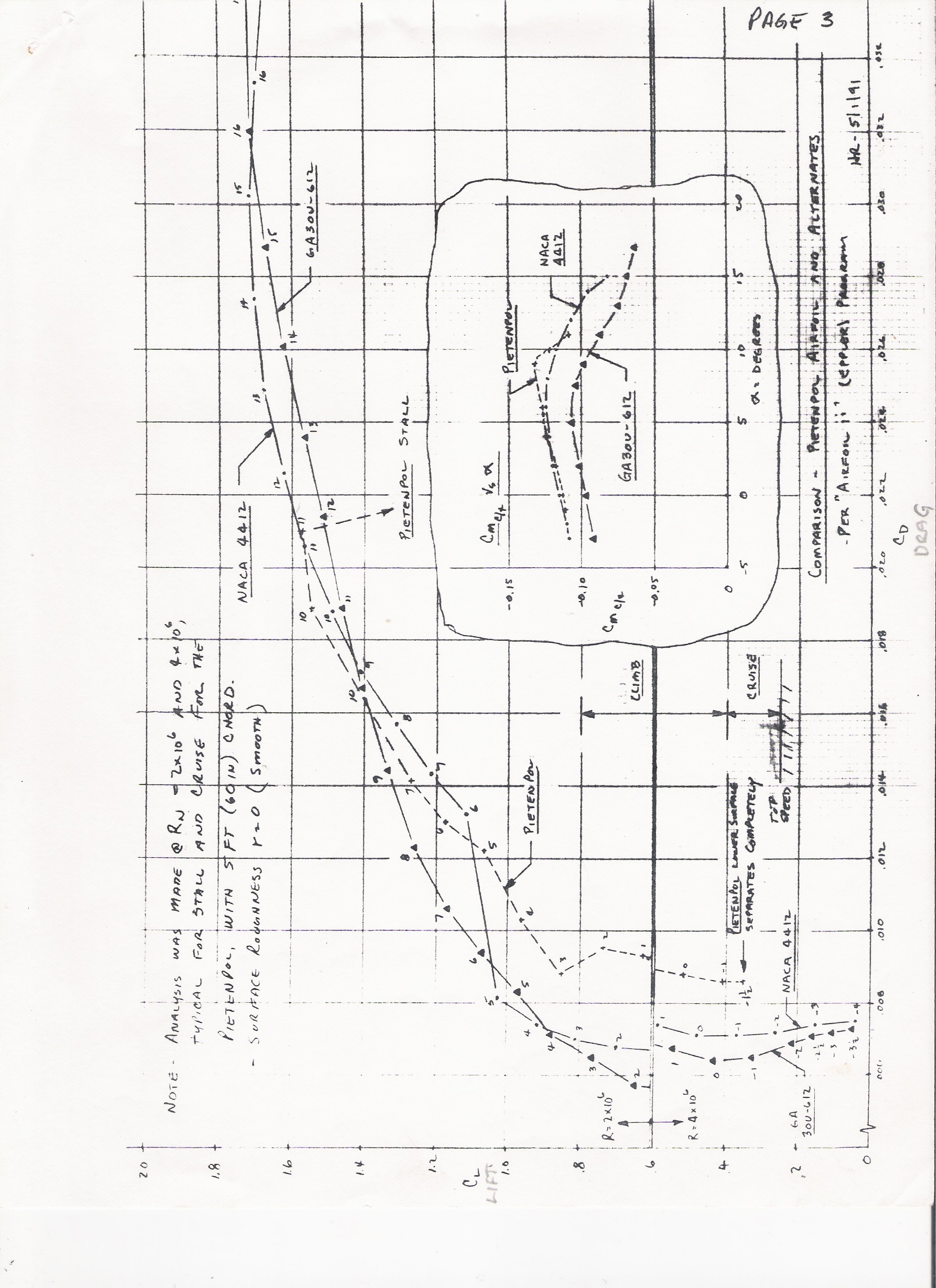

Message 3
      Riblett's letter to Pieti Lowell, ref air foils for a Pietenpol
      http://forums.matronics.com/viewtopic.php?p=197525#197525
      http://forums.matronics.com//files/riblett_p2_118.jpg
      http://forums.matronics.com//files/riblett_p1_976.jpg
Message 4
| Subject:  | Riblett's grafts |
      The lift,stall and cruise of the Piet, 4412 & 612 airfoils are very interesting
      to those that need more lift.
      http://forums.matronics.com/viewtopic.php?p=197529#197529
      http://forums.matronics.com//files/riblett_p3_653.jpg

Message 7
| Subject:  | Re: Riblett's Info |
      Lowell,
      Thanks for posting this.  Some may not know of your experience with various airfoils.
      Of course, you are one of the few (maybe the only one) who has changed
      wings on the same plane with the same engine,and changed engines with the same
      wing and plane, and then changed both.  You can report empirical data on the
      effect of each of the changes.
      I think, based on talking with you about this earlier this year, and our more recent
      discussions at Brodhead, many builders should use either a Riblett GA30U-612
      or a GA30U-613.5 instead of BP's airfoil.  I believe you agree with that
      evaluation as a good decision for all but Piet purists.  (Room for all instide
      the tent.) And we have discussed the merits of both these Riblett airfoils.
      I'd like to lay out some impressions of the 613.5, and see if you will confirm
      or change this post, for the benefit of others considering these choices. I'll
      ask you to pardon me in advance,if I am misinterpreting any of our discussions,
      or if I have crossed them up with similar discussions with Bill Rewey or Roman
      Bukolt.
      As you know, and as we have discussed, the 613.5 is "fatter" than the other airfoils.
      You and I have discussed its comparative merits.
      For the benefit of others on the board, the 613.5 has more loft on the Y-axis and
      a bigger radius, resulting in more camber.  Otherwise it looks much like the
      NACA 2412 or 4412 and the Riblett 612, all of them peaking "Y" at 30 percent
      of the "X" (chord). All of these have better laminarity than BP's airfoil in
      the early part of the airfoil, before the airflow "goes turbulent."  (All are
      characterized as "turbulent airfoils," but some are more turbulent than others.)
      The Riblett GA30U-613.5 seems to me a better choice for a Piet with less powerful
      engines, such as most Model A's (not your fuel-injected baby) or Continental
      A-65s.  I think you have agreed with this opinion, perhaps even postulated it
      yourself.
      The 613.5 would give the Piet builder a faster climb, better safe payload on hot
      days, etc.  A wing built with it would weigh a little more than one using a
      612 airfoil-- how much more depending upon whether the builder uses filler blocks
      at the top of each spar or a full-height built-up ply and wood spar.
      Alternatively, the 612 might be better for higher hp Piets.  With 100 hp or more
      the pilot gets a faster climb in any event, and the 612 would have less drag
      and allow a faster cruising speed than the 613.5.  And as you and Mr. Riblett
      have reported, there are no negatives associated with the 612 when compared to
      BP's original "FC-10" airfoil. (We may not know that much about the pitching
      moment of the 613.5 as yet.)
      Do you agree with this discussion of the 613.5 vs. the 612?  And with a 612 foir
      higher hp Piets?  Is this the right way//a right way to think of the choices?
      Tim in central TX

Message 8
      Tim , as per usual, you are on track, Riblitt's better design even over the 612
      is the 613.5, As you know it is easy to see the difference . But you can also
      carry a larger fuel tank in the 613.5.
      Lowell
      and allow a faster cruising speed than the 613.5. And as you and Mr. Riblett have
      BP's original "FC-10" airfoil. (We may not know that much about the pitching moment
      Tim in central TX
      -----Original Message-----
      >From: Pieti Lowell
      >Sent: Aug 9, 2008 11:38 AM
      >To: pietenpol-list@matronics.com
      >Subject: Pietenpol-List: Riblett's Info
      >Read this topic online here:
