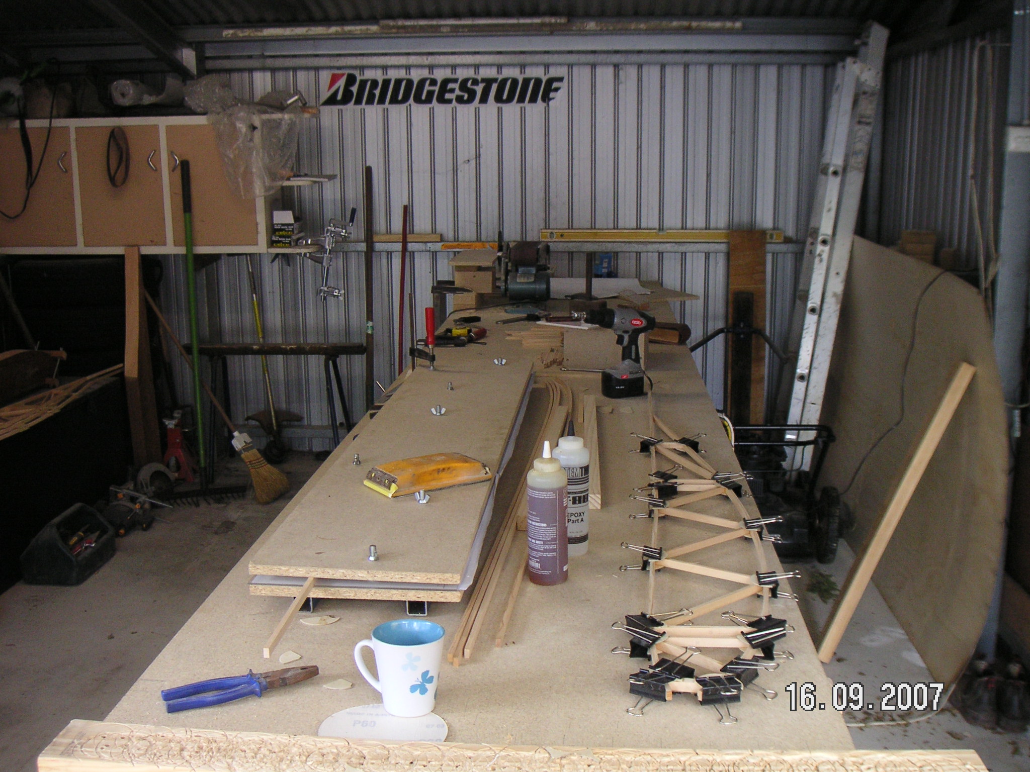

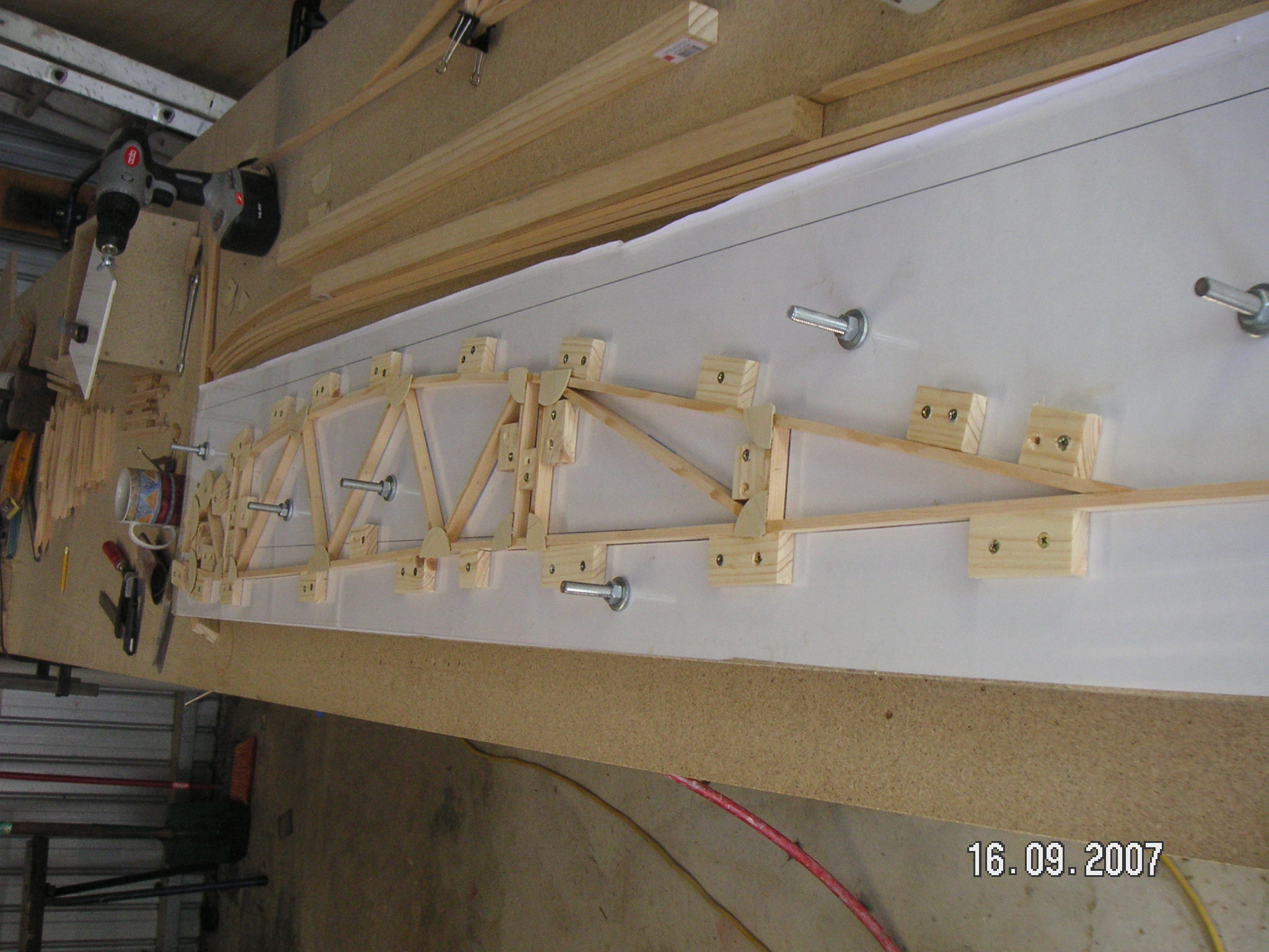

Hi
Here is the method I used,I stole ideas off some others on this list and it worked
a bloody treat.One side goes on in the jig and then the other using the same
clamps as Jack used no nails needed. Hope it helps.
Carson

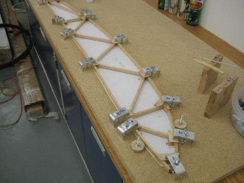

| Subject: | Re: No clamps on ribs? |
I'm with Glenn, had a blast "engineering" and building a clamping jig. The ribs
are built and epoxied very easily and have been impressively consistent.
It's just one more sample......
Steve
